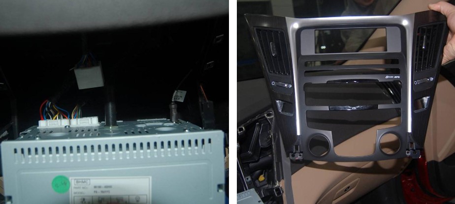

Installation was very easy. Just pop off the vent, remove the two screws holding the original head unit, pull the head unit out, remove wiring harnesses, plug in harness adaptors, and hook up the new head unit, then put everything back in place. It looks just an OEM head unit, and the buttons have the same kind of style as the factory one. My only issue with the hardware is that the backlit keys are always on, whether your headlight switch is on or off.
