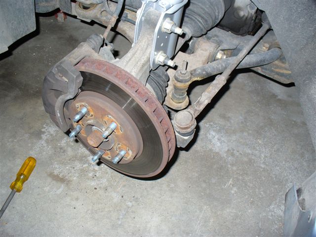

yes it makes sense but i have used an impact gun in the past. living dangerously. take a look at the end of the sway bar. does that look odd? hard to see unless you zoom in. this is a friends car. he lives in another town. says the front end clunks. looks like a broken sway bar to me.

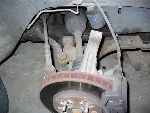

this is the other side. i could not upload both pics together.

the car is my sons. he lives in another town. i looked at it yesterday. swaybar is fine. just some sort of support tab under the bar attaching point. not sure what it does. i drove the car over a good bump in their driveway and get a good squeak from the drivers wheelwell. i am going to try replacing the lower control arm. new bushings/balljoint so that will take care of just about everything that can make noise. or maybe swaybar bushings. next.
