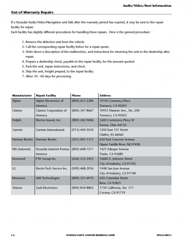

I think the problem is internal to the audio unit. I think you have one of 3 choices here. 1) Have the existing radio repaired. 2) Purchase a OEM replacement unit from the dealer or 3) purchase an aftermarket unit from some place like Crutchfields. Repairs for Monsoon audio units are handled by AER Technologies listed in the attachment. I would call them first for shipping instructions. Most folks would move on and look for a better aftermarket unit.
