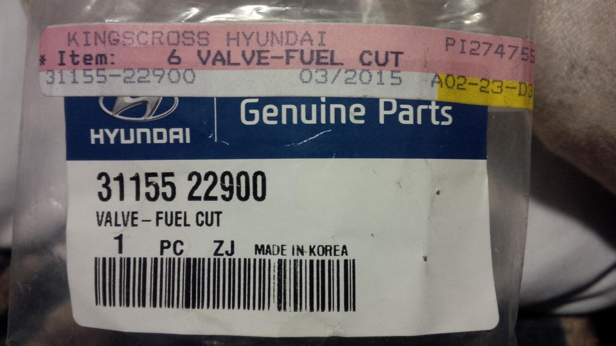

Ichi - good news; problem fixed. You were right. When I removed the rubber hose from the fuel tanks filler neck I was able to see right into the tank. There was nothing stopping the fuel from coming back out. My mechanic did not think to look in the old tank for this part. I called the dealer and got the part. I forgot to take a pic in my excitement however can describe it: 5-6 inches and fits into the fuel tanks filler neck like a sleeve. Just slides in. No bolts/screws. The part number is: 3115522900 - valve-fuel cut. Image of part bag attached. $9.99. Dealer part.
Went to the gas station, filled up and NO spit back
Attached is the fuel tank schematic. The part in question is 31155A and 31161B. This comes as one part.
Remember, when having a NEW fuel tank installed make sure to transfer the fuel cut valve from your old tank to the new one!!!
Hope this is useful for others.
James
