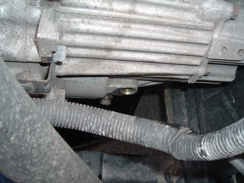

Fill (bolt removed in picture):
Attachment 1701
