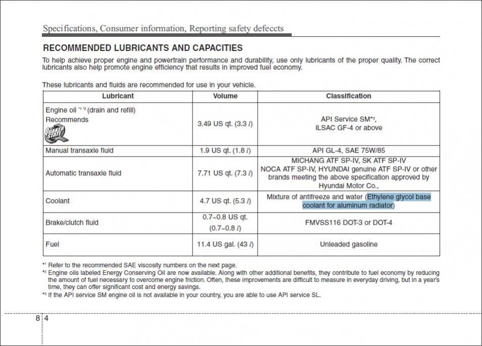

Yep. Your car should have come with a Maintence Log pamphlet and in it gives the spec of what types of fluids the car requires.
I have a jug of valucraft autozone antifreeze 50/50 and it has just ethylene glycol.
Ford and GM is notorious for requiring their own special antifreeze that most autozone/discount autoparts don't carry.
Thanks for the link. I saw the "ethylene glycol" recommendation and that is what had me worried. Ethylene glycol is what my dad called antifreeze back in the 1970's. It seems there would be a spec something like Ford uses, i.e. M-4763-R29A. That way you could know for sure.
I guess if I go to the dealer and buy a bottle of Hyundai antifreeze labeled "ethylene glycol" then I would be alright?
