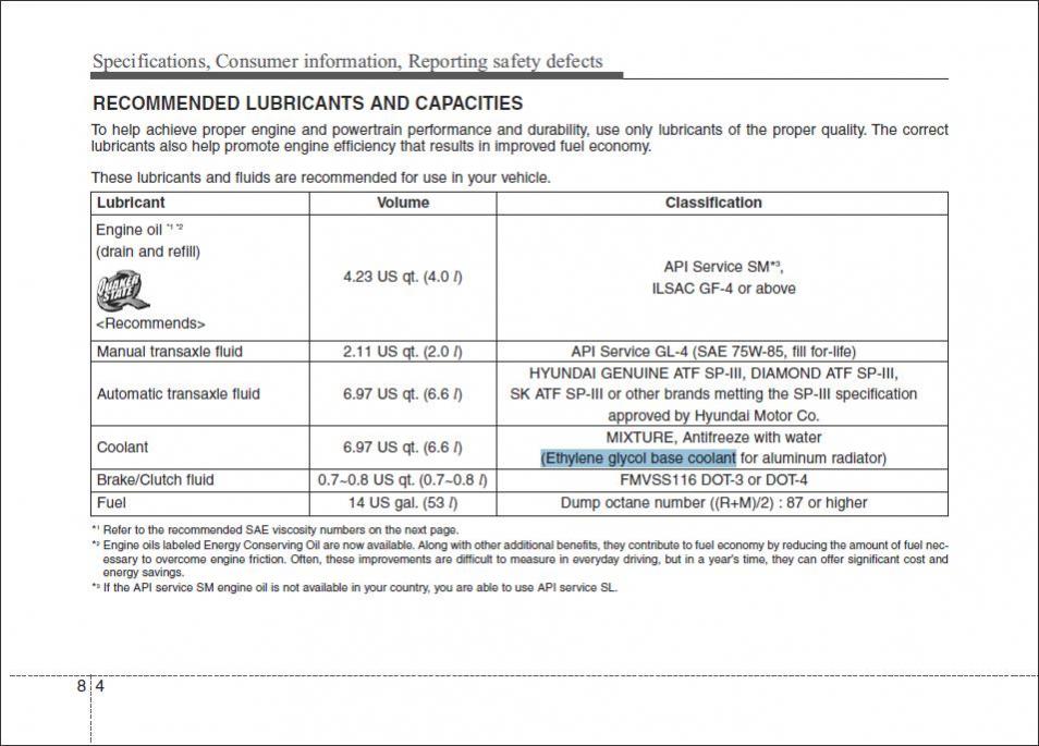

What type of coolant needs to be put in Elantra ?
Do I need to go to the dealer for service to maintain the warranty on the car ?
Have you checked your owners manual? See page 8-4:
