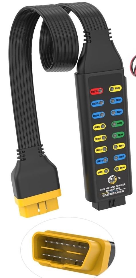

It's an Elantra, 2.0L FWD SE Sedan, manual trans.
My OBD didn't power up from the OBD port so I connected an OBD breakout box (
Amazon Amazon
) to it and found zero volts on the power pin.

I found the problem. When I installed the Schumacher Memory Saver and disconnected the battery, the cabin “1 MEMORY” fuse blew, undoubtedly because the OBD/memory saver’s power pin tried to power the car and exceeded the 10 amp fuse limit. The memory saver should have a current limiter. This solved a handful of other issues with the instrument panel that I haven’t mentioned. And the OBD's power pin now has power. All is good now.
