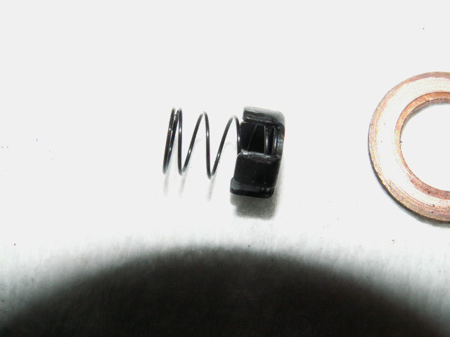

With that restrictor valve gone, and an F1 Stage 1 Clutch in it, can I expect a huge change? With this restrictor gone, will there be significantly more wear and tear on the tranny?
P.S. is this the check valve I read about in another post? :

I totally appreciate the pics, I will be printing them out and showing them to my mechanic once i have enough money to change the clutch.
No, it only affects rate of fluid flow back to master when you let off pedal, the small hole makes fluid return slowly to the master, so there is more slip until clutch locks up... remember you stated you revved engine up and dropped clutch and it spun for bit till it locked up...
Yes
Yes
