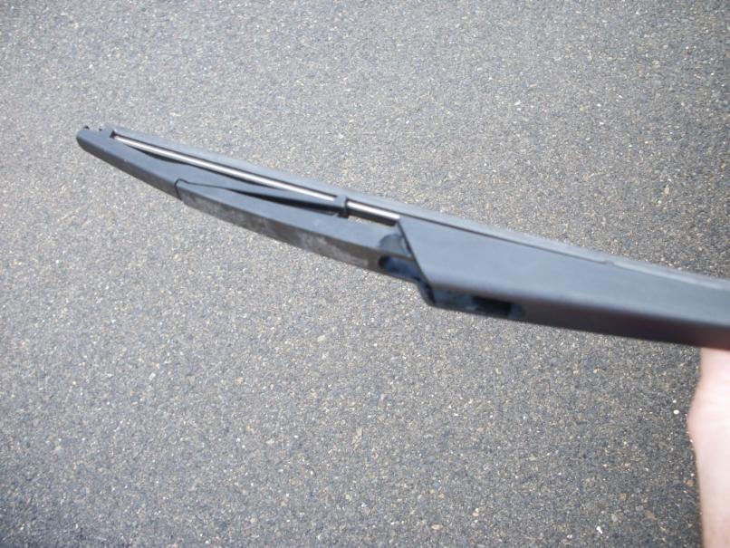

Here's the pics from my van. Just pull the arm up off the glass and while holding the rear part of the arm, pull the front half off.
