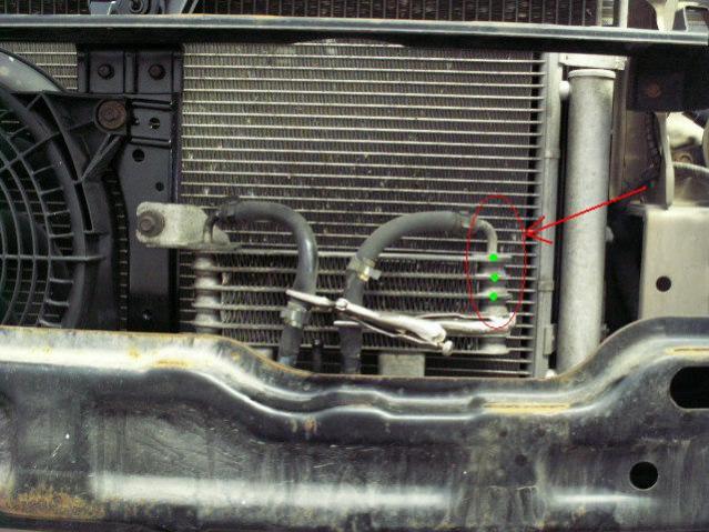

Easiest thing to do is just look at it,, good light and eyes through the bottom, or open the hood and look down on it..
Common place to leak is the cooler. Was recall on the tubes that pass under radiator the yr before, so rusty tubes "could" also leak
We see them leak in the circled area at the green dots all the time --
The car in picture was in process of getting tube replacement, that why the bumper cover is off (photo opportunity there).
