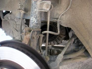

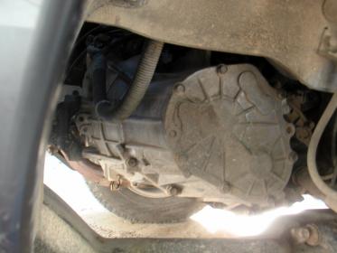

Hello, picked up a reasonable 2ndhand 2001, changed every fluid (diffs, engine etc.) but can't find the fill for the manual transmission, any help appreciated.
Attachment 457
Attachment 458
Is it that bolt on the second pic on the transmission casing. Hey a pointer as to where the drain plug would be nice.

sbr711 Sep 27, 2010 02:21 PM
Hit the Hyundai dealer for 3 qt of 08950-00020 oil... DONT USE 80/90 GL5 !!

sbr711 Sep 27, 2010 02:53 PM
75/90 /// 80/90 GL5 is reserved for the transfer case and rear axle out back..
The GL4 stuff is hard to find on open market, best to use the number I give you and keep from killing the brass rings inside the gearbox.
The Hyundai oil is approx $16/qt... number may be valid at Kia if closer to you.
