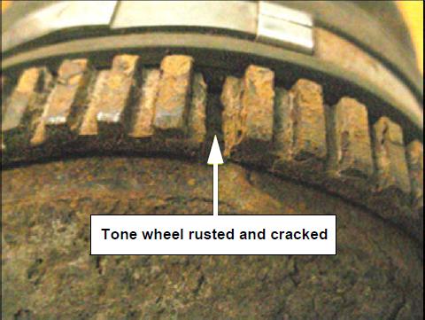

My best guess would be a broken tone ring on the front wheel speed sensor. A common issue with Santa Fe's. They rust and crack.
https://www.hyundaiforum.com/forum/a...tone-wheel-jpg https://www.hyundaiforum.com/forum/h...s-light-10764/ https://www.hyundaiforum.com/forum/h...engaged-12379/ |
