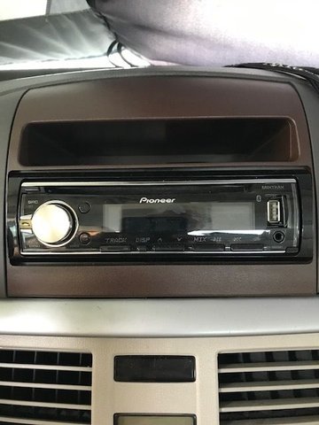

Sorry I'm tardy with these pictures. Attended a wedding with the misses in Michigan. What's with the groom's friends wearing stove pipe high water pants which show multi colored socks with long tipped shoes and a tight fitting jacket.....yuck! My baggy suit from the 50s drew disgusted looks. Anyway, my radio setup shows a button arrangement on the steering wheel. My existing wheel had a plastic blank in that location. After pulling off the horn cover I noticed some wires and attached them to the new switch. I then attached the wires under the dash to a little box that had a I phone like ear bud plug to the back of my used Pioneer radio. Apparently, most if not all 3rd party market radios have that plug socket. I'm able to adjust the volume and change songs thru the steering wheel....neat. Next you will notice the different color radio mount in place of the old radio.....couldn't match the dash color....cost about $25 bucks and love the cutout where I can place my I phone. Last I mounted the Amazon 8'' speaker and used Sony low power amp in the trunk. To make it tidy I put the white plastic around the wires. I especially like that the radio is bluetooth.....no wires hanging down and works every time. Did this about 4 years ago and I still enjoy the nice bass....u will too! good luck
