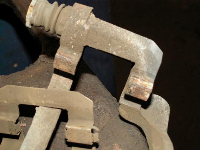

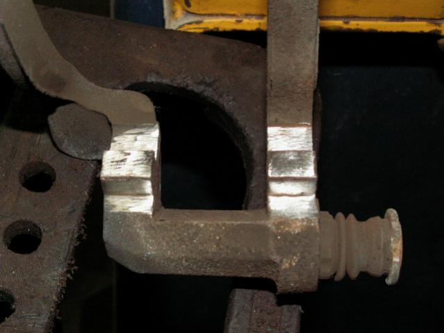

Your pads were stuck in the mounts due to normal exposure to the elements (rust)..
So you just removed the old pads and stuck new pads in ??? Did you have to beat them into the mounts ?
Correct procedure is to remove the mounting bracket, pop the shims off, and knock the rust off down to bare metal.. ( usually spray some under coat on the fresh metal as we have it currently for recall cars), re-install the shims and pads.. pads should flop around freely so they release from rotors when pedal released..

There is no TSB for rust.
Pop the pads out, remove the mount, and grind away the heavy/thick/chumky rust that has growed under the shim and effectively locked the pad in place.
Warranty does not cover exposure to elements.

Checked my brakes this morning. The right rear disc brake does show significant rust. I still can turn the wheel by hand but decided to see if brake pads can move freely. They bind. Took them out and removed the shim to clean out the rust then coated the surface with brake grease. The brake pad still have 6.8mm thickness and rotor is good. Put them back and they move freely now. I had the car parked outside past winter and only drove once every couple weeks, that maybe why rust developed so soon, but I did not have any problem until now (Fall). Never had any problem like this with any of my cars before. I always drive Chevy. My 99 Malibu rear (drum) brakes are still doing fine at 135K miles. This is my first Hyundai.
