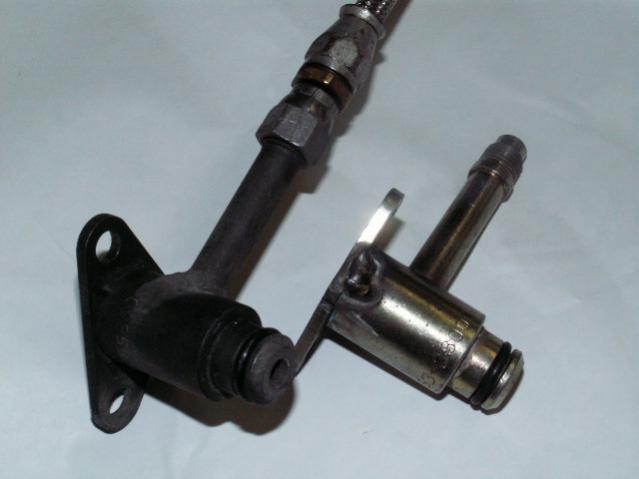

anyone figured how to do this? I confirm there are 2 lines in my 2001 Sonata 4cycl. One has 2 bolts and the other is a rubber hose with a ring. I suspect the hose with the bolts is the fuel line and the rubber hose is the return? Can anyone confirm on that? Thanks.
You need the adapter from the Hyundai fuel pressure test kit.
Remove the pressure line from the rail, then install test port adapter in between rail and fuel supply line... then install fuel pressure gauge...
I'll take pic of it later today..
You can check pressure from the hose that has the clamp on it. DO NOT remove the one with the bolts holding it on. Unless you got the right adapter, which I didnt. that hose that goes to the intake is a vacuum source for the pressure regulator. I used the autozone fuel gauge rental deal. Take the clamp hose loose and put a 1 or so foot piece of hose on, then use the T fitting and attach the gauge. then attach the hose you removed to the other side of the T fitting. That hose is the return fuel line to the tank. Now turn key to prime the pump and see what pressure. Then crank and see the pressure. Then rev the car up to about 4k and see the pressure. It should not drop.
