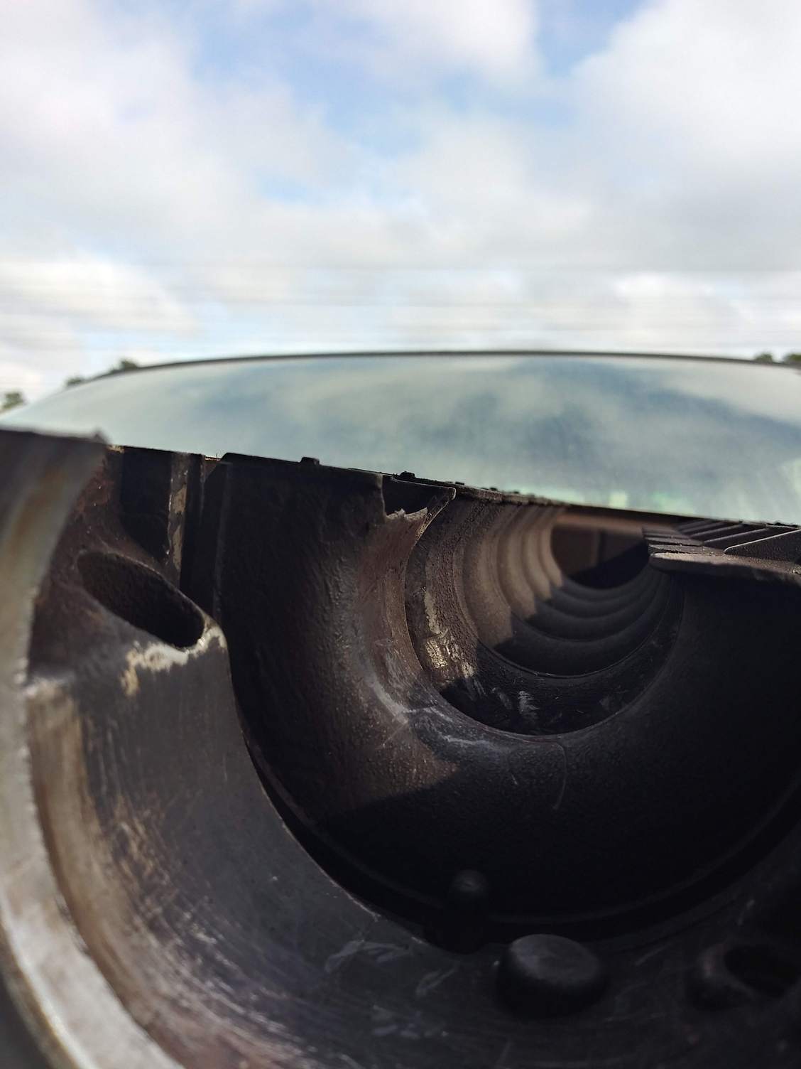

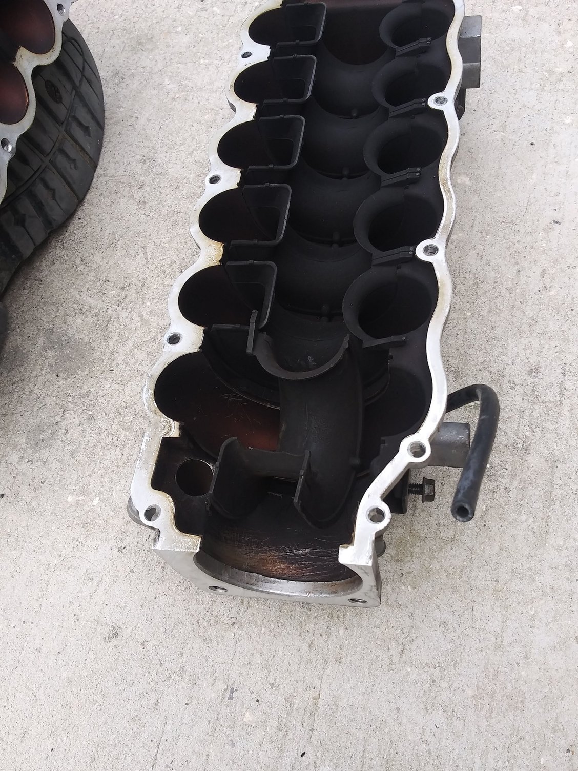

Also i would like to add that even after i replaced the vacuum hoses with the factory required equipment the code changed to a code from the throttle body which i clean but still had the same issue and same rough idle and sputter. After intense troubleshooting i will share with you another problem that many overlook but points to the throttle body when that isn't the issue at all. So let me introduce you to a known problem that i have now found with about 3 other XG350 that i now own that had the exact same issue. This is the Plenum Intake Manifold which has fins on the inside to direct air and will give you a combination of codes if the PROPER COLORED VACUUM HOSES after install gives you another code.
