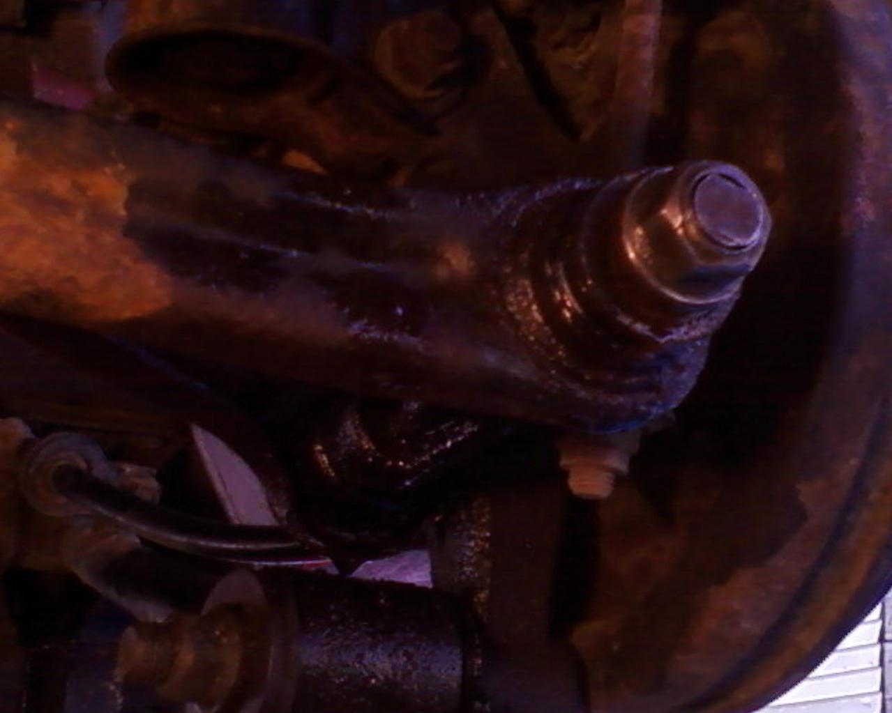

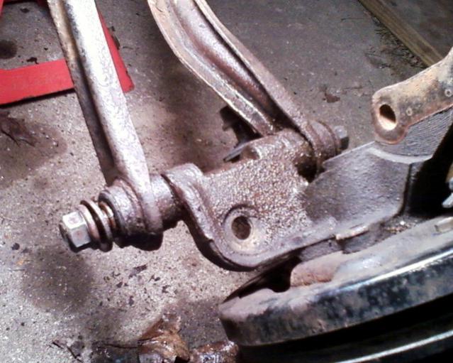

I CAN NOT get this bolt out! I have been soaking and soaking it with JB and WD40.. Have put a little heat to it however i do not want to cheery red too much because the steel that is being used for this bolt and the wheel control assy is sub standard and I am sure that any temper that is will be lost and then i would be looking at replacing the this cast assy... Here are a few pics. Impact will NOT budge the bolt in either direction and I have mushroomed the threaded end... What else can I do to get this bolt out?

Default after speaking with some techs
yeah yeah I know this has taken forever and it is still not accomplished, but my day is roughly 18hrs long 8days a week!! However I spoke with a mechanic of these cars last week when I thought I was going to take it in to the dealership and was told that it can be a tricky process with the heat, but it is necessary because of the disimalar metals and the fusion that occurs between them. LITERALLY!!! I knew all this already! Anyway I hope to get this done today.. Wish me the best
