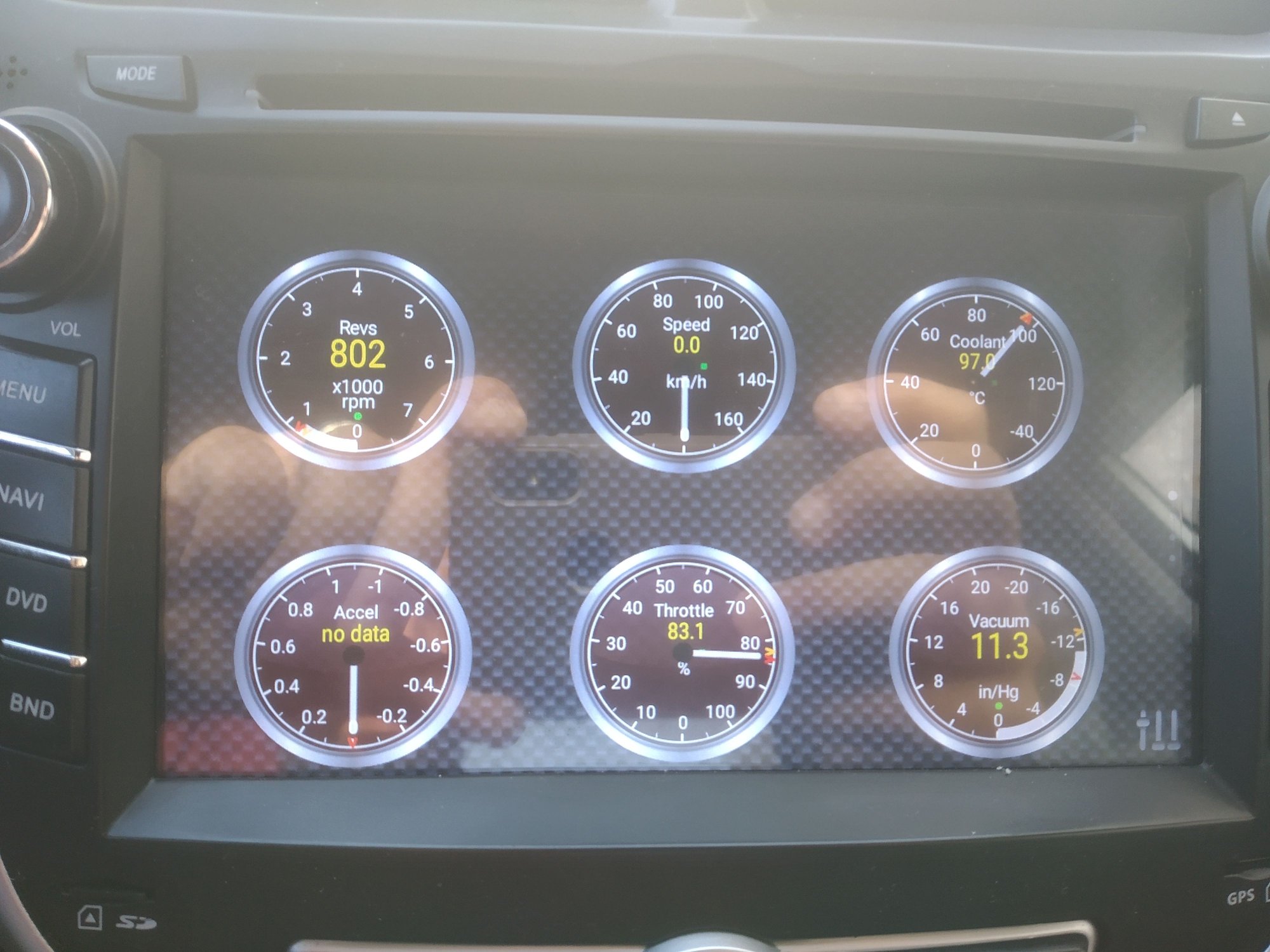

Sometimes when I stand at idle (every 800 km), the engine seems to vibrate more than usual. but RPM is normal and no check engine. i notice that when happened, throttle position in 83.1 not 13.3 as normal.
about 20km after that engine and throttle goes to normal position and no vibrate.
picture below describe throttle position.

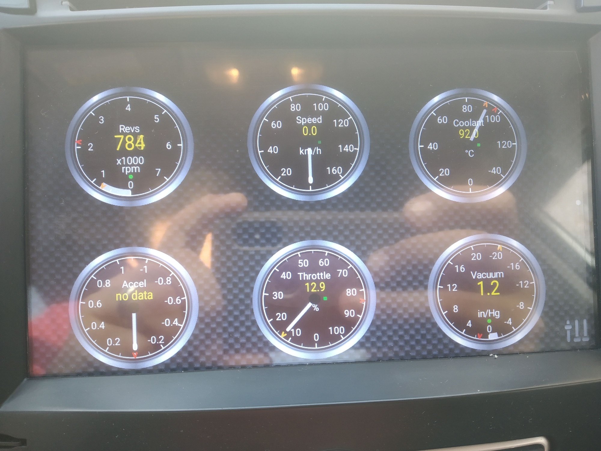

Sorry for the delay, but I was waiting for it to happen
Attached are pictures of the normal idle and shakes idle
Old Sep 4, 2021 | 11:26 AM
Posts: 2,895
If you look closely at the throttle position and engine RPM , you will see the last picture posted shows the throttle practically wide open and yet the RPM is at idle position.
Something not right with throttle position sensor reading.

this is another data from idle when no shake

Your gauge readings are already telling you something is wrong with the sensor. Just have it checked out or just replace it.
