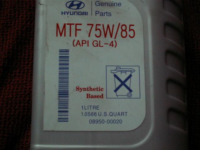

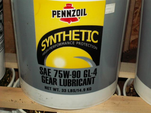

Do not use just any plain old gear oil you find...
Hyundai M/T school sepically calls for GL4... most common you find are GL5, and GL5 has different additives, and is tackier/more clingie than GL4., and the GL5 will ruin the snchros in the M/T
Current Hyundai bottle of GL is 75/85, part number is 08950-00020, cost approx $16/qt..
Last dealer I worked had Penzoil in 5 gallon, for customer pay jobs, the Hyundai stuff was reserved for over counter sale and warranty.
