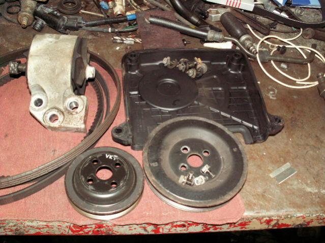

Whan the nut off the crank, tweak it to align the marks.. flip the belt, adjust tension, re-assemble.. wham the bolt on the crank pulley, dont matter if it turn, you already got the timing belt on and tensioned..
Attached Thumbnails so i'm replacing my timing belt...-pict0004.jpg   so i'm replacing my timing belt...-pict0005.jpg   so i'm replacing my timing belt...-pict0006.jpg   so i'm replacing my timing belt...-pict0007.jpg   so i'm replacing my timing belt...-pict0010.jpg
