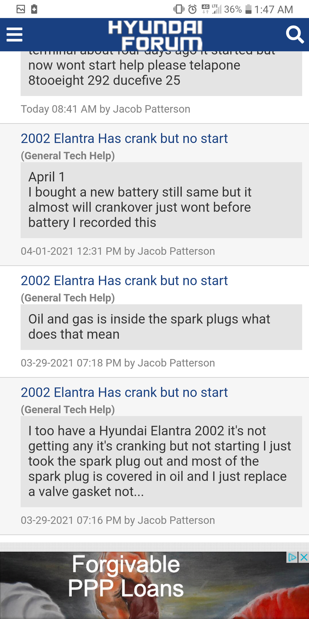

help runing out of things to check

So we are all on the same page,
Usually , when attempting to start the engine , we say it cranks over, means the starter is turning the engine over.
Once the engine starts up , we say it fires up.,is running .
What we look for when we have a no start,,,, do we have spark , fuel and air ? The engine can't run if either of these is absent.
If it won't start after we have those three and it still won't fire up , then we get into more complicated tests that require equipment most folks don't have.
So,,,,,,,,,,,,,,where are we here?
