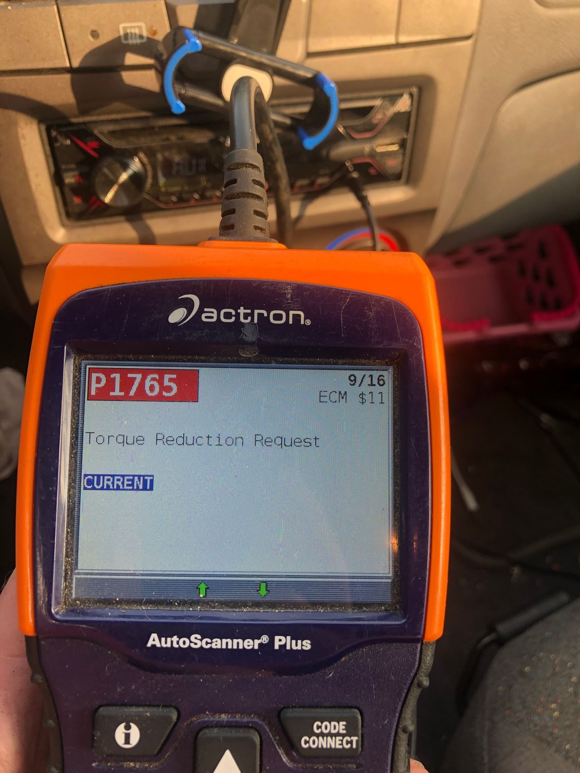

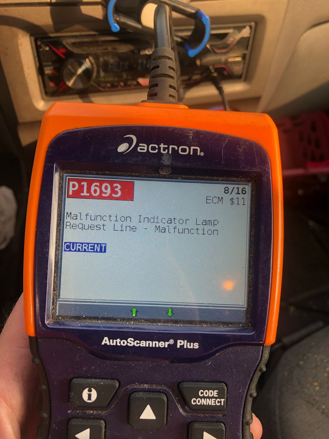

Default Where should I start with my 02 Hyundai Accent

How many miles or km on this car?
This is now a 17 yo car. Rubber parts are hardened and brittle and prone to cracking. That small leak could be the gas cap. Inspect the gasket and the rim of the filler for dirt corrosion and other defects.
How old are the spark plugs? If you don't know take them out and inspect them.
I guess this car has coil packs and plug wires. There is a good chance they are burnt out or cracked and leaking voltage. In the dark run the engine and spray water on the plug wires. If you see any sparks replace all wires.
Report back.
