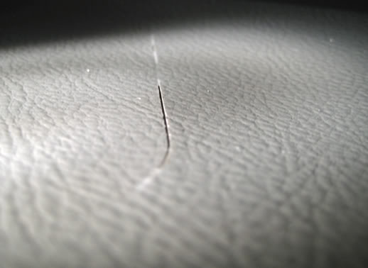

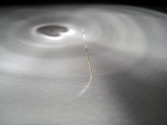

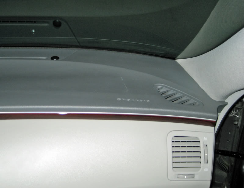

My wifes 2006 Azera Limited has a crack in her dash that she spotted a week ago. The car has 16k on it and I couldn't imagine the dash cracking...?
But yes it is actually cracked, it seems to be around the deployment door that would flap open to let the airbag out. The stretchy crack seems to curve at the end as if it is following the airbag door...?
PS: I have never used Armor All... My father told me ever since I was a kid it cracks dashes... I use a terry cloth & water... Thats all... L :(
Attached are some photo's I took of her dashboard: :(
Attachment 2059
** Top right look at the crack...?**
Attachment 2060
** Close-Up of the crack notice it turning left toward the other end of the airbag panel?**
Attachment 2061
**Close up of the crack... So sad!

That is pretty strange... I wonder if the airbag had a malfunction and tried to deploy. Was it there all of a sudden, or small at first and keeps growing?

I noticed in one of your close up photos that the dash material seems somewhat thin. Another problem with the Azera may be the fact that the dash surface is flat and quite large, similiar to the older GM cars. Does your wife work, and if so,is the car left outside all day?

As for the material it is the seam around the airbag like I thought it was that is shrinking and eventually cracked. My wife parks it outside everyday and uses a sunsheild. Her VW turbo beetle never had this problem. Heck that dash was like 5 feet deep!! And she never shielded it from the sun... Oh well live and learn I guess...

Good photos. I agree the cause is the airbag deployment seam. It was probably cut (or molded) too deep and direct sunlight shrinked the (likely)urethane foam; as an old plastics engineer this has happened before and it is almost impossible to weed out in quality checks. The dealer probably wuill have a wait of at least a week for a replacement part and it should take at least 2 days to replace. Dashboards are a very difficult place to work on. Be glad it should be a warranty repair. cheers.
