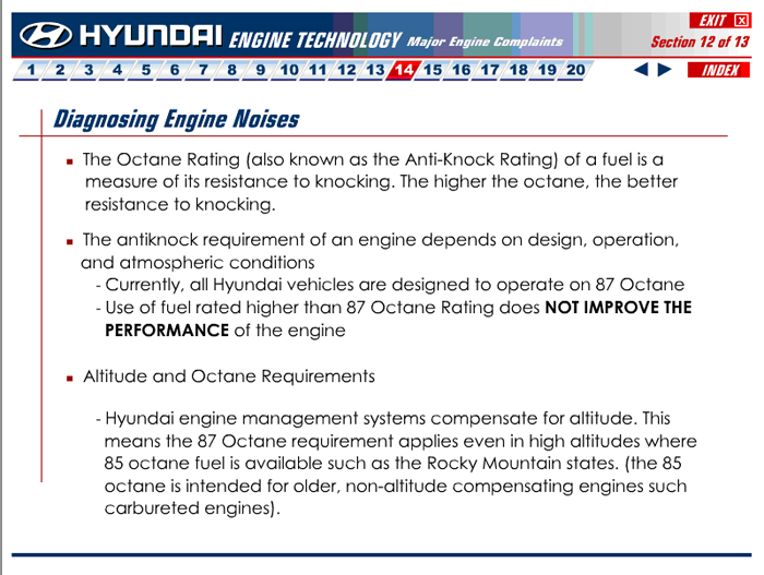

Don't waste your money on fuel above 87 octane. All Hyundai vehicles are designed to run on 87 octane fuel. You get zero performance or mileage gains from using higher octane fuel. It's just a waste of money. Reat the pic below:
Personally, I use BP (Amoco) fuel in both my Huyndais and have never had a problem. I actually perfer BP/Amoco and Chevron. Unfortunately, I can't get Chevron up here in the NE.
