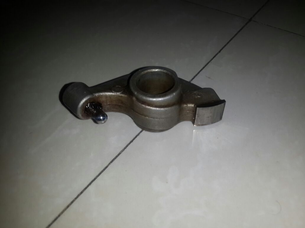

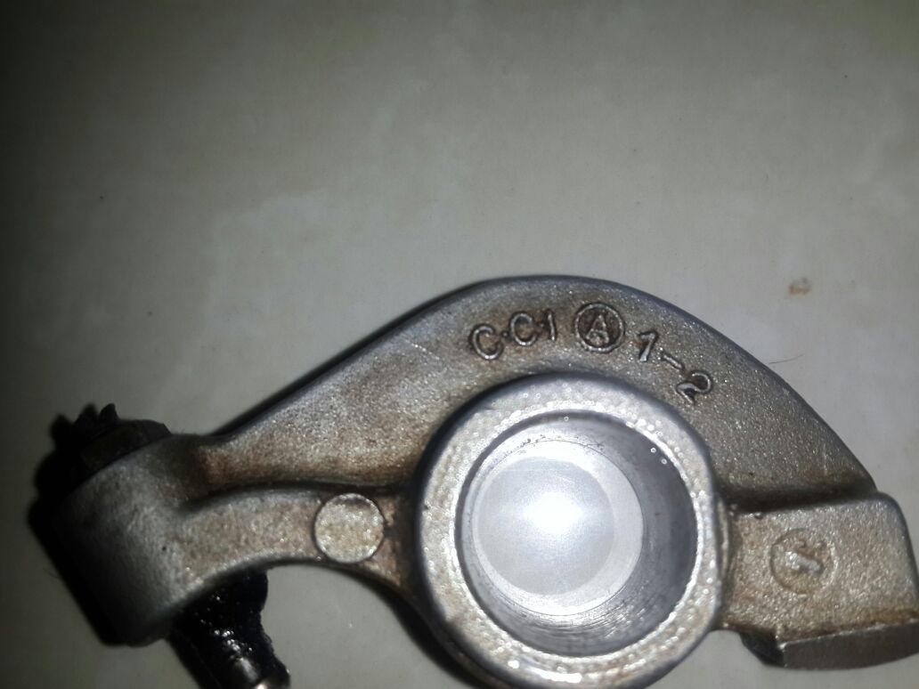

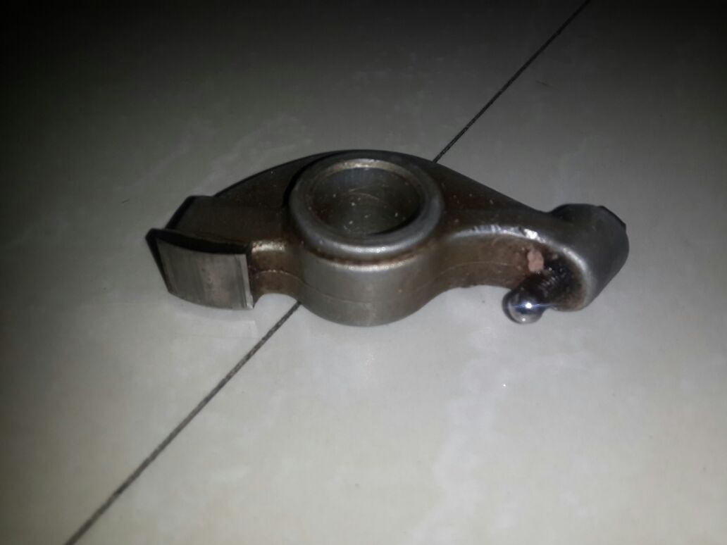

I have a Hyundai Scoupe 1993 and I'm looking for two parts (I need to import them) which I can't find here in my country, I'm from Venezuela. I made a picture (I attached the images) so if someone can help me telling me which the name of the parts is and where I can purchase, I would be glad. I'm told that I need six of each one.

It looks like a "rocker arm".
They sit on top of the valve stem with a spring.
24552-22000 Rocker Arms Exhaust
24551-22000 Rocker Arms Intake
Found on "hyundaioemparts . com/auto-parts/1993/hyundai/scoupe/base-trim/1-5l-l4-gas-engine/engine-cat/engine-parts-scat"
