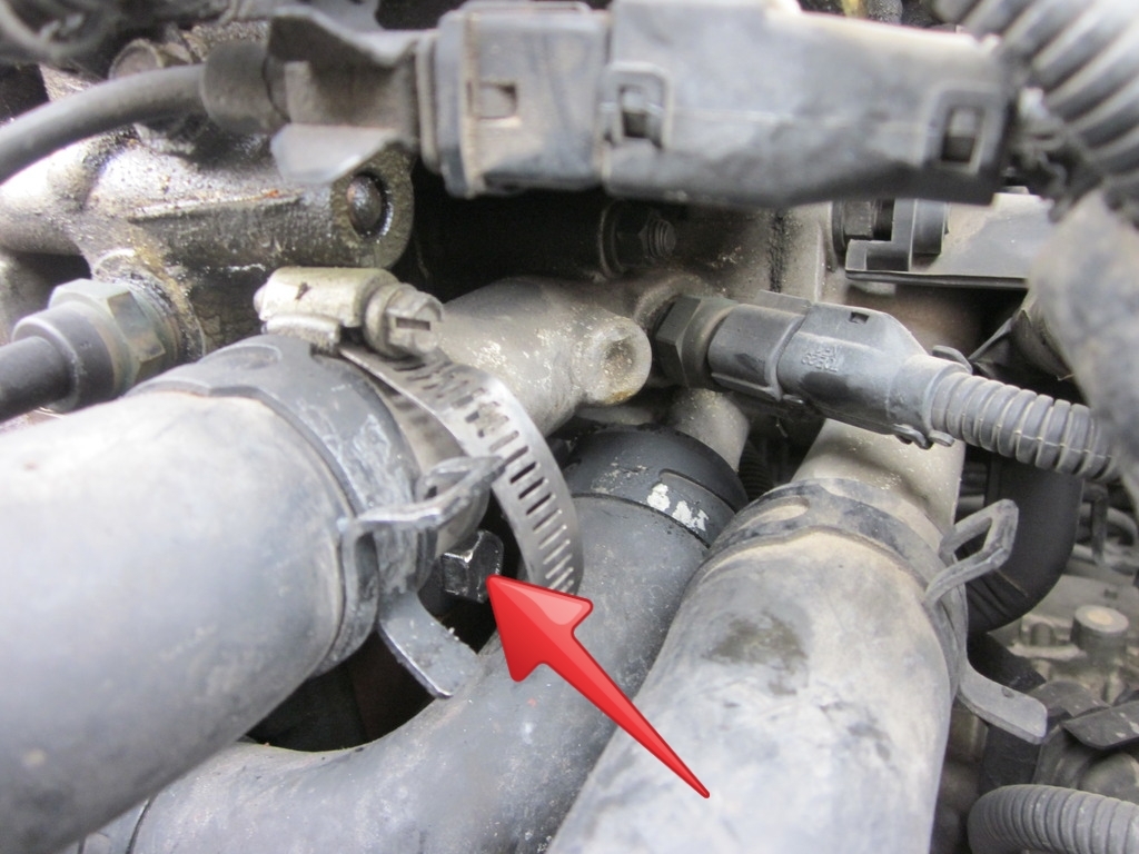

1 Attachment(s)
In case anyone can't find the filter for the OCV, here it is in the photo. This is not the OCV itself, but the screen filter. You remove this 14 mm bolt shown in the photo and pull it out. You can clean it with brake cleaner:
Attachment 1609 Thanks to NovaResource who described to me where I can find this screen filter. |
