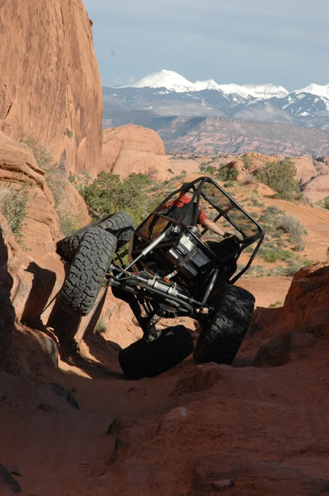

Suspension parts, I know those all too well.

Obviously, anyone who builds and maintains his own rock crawler would know the difference between the transmission and the suspension parts (Moab region?, Cedar City?, City of Rocks in ID?). Lots of rotating items inside the tranny that could make this noise. The more I ponder this problem, the more I'm inclined to think a problem has developed with the solanoid or springs on the solanoid that lock the overdrive. It's not fully disengaging, producing the tick, tick, tick. That's my SWAG, I'd like to hear back what the problem actually is once it's diagnosed.

That pic was taken last year when we were out at the (2007) EJS in Moab. We roll our rigs over on a consistent basis, drive them when we're on our sides and in doing so are going from 1st to reverse and back again trying to upright them. Occasionally we hit park We end up on the roofs as well. We slam these undercarriages on rocks, either coming down on them or jumping up onto them. I have never heard a noise like this coming from the tranny's. We've cracked the tailshaft sections of the housings, had the tranny and radiator vent tubes go to the same overflow canister (sucked up anti-freeze into the tranny after a roll ) and after a hard year or two the tranny's get a little lethargic and they need to be rebuilt, then they're ready again for the abuse.
