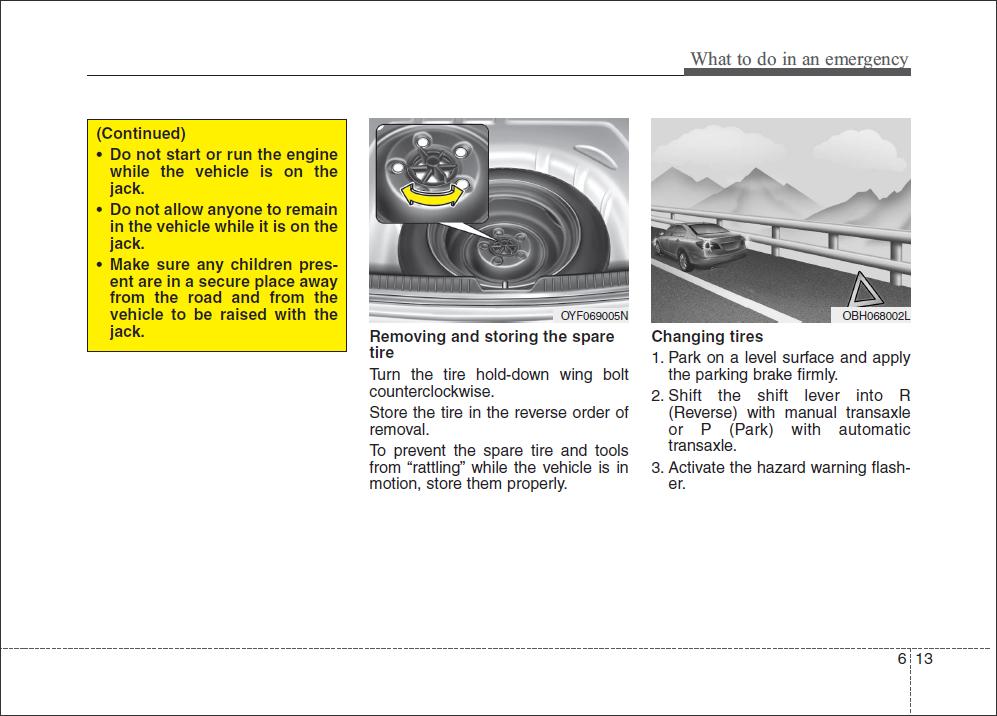

Just picked my special ordered spare dounut, jack, bar, and wrench. The hold down clamp is on order. Will have on Wednesday. Got everything from Turnersville Hyundia in NJ. Purchased the car there in January. The service manager was very helpful in getting these parts for me. I found out the Elantra's in Canada come with the spare tire set up. Anyone have a picture of how everything gets clamp down in the trunk?

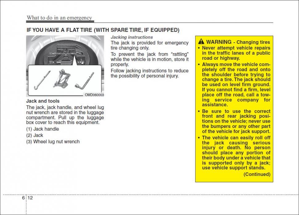

Have you tried looking in your owners manual?
Pages 6-12 and 6-13:
Attached Thumbnails Got my spare dount for my new 2011 elantra-2011-elantra-6-12.jpg   Got my spare dount for my new 2011 elantra-2011-elantra-6-13.jpg

The dealer cannot get the specific information about how to put back that scissors jack and lug wrench and the little handle for the jack? I'm sorry I'm not of much help. I just threw them in a box in the trunk and some warm afternoon when I'm bored I'll figure out how they fit back on that cover upside-down.

I put mine together tonight. The compact spare tire goes in upside down, with the holddown bolt screwed throught the center hole. The styrofoam insert with the jack, handle, and wrench compartments fits down in the center of the spare tire. the cardboard trunk insert goes in last.
The spare still holds 60 psi and the wheel torque is only 79 foot pounds.
