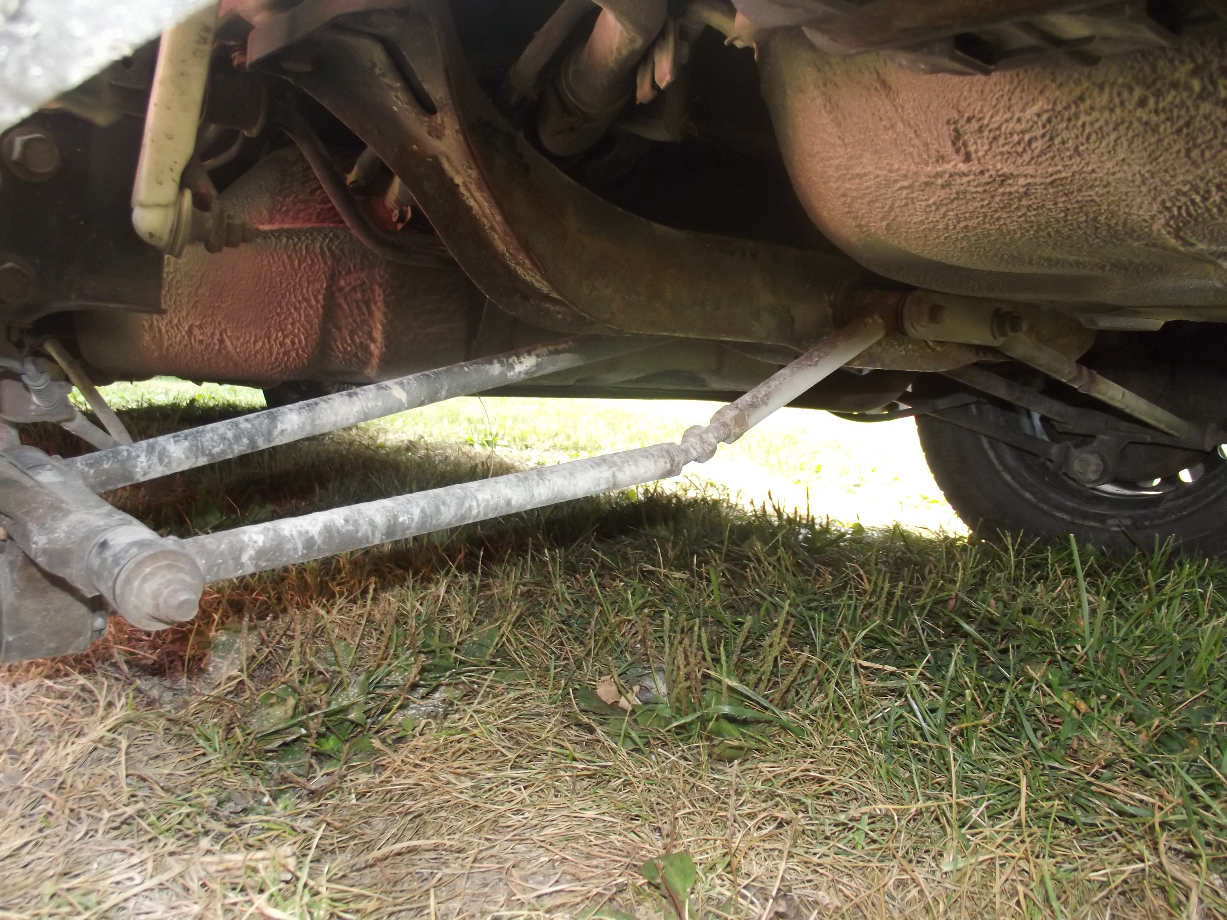

My wife drove my 2005 Elantra into a ditch and I need to know what she bent. Any advice or information on repairs would be a plus also. Thanks!
Attached Thumbnails I need HELP Identifying this Part-car-001.jpg   I need HELP Identifying this Part-car-002.jpg   I need HELP Identifying this Part-car-003.jpg   I need HELP Identifying this Part-car-004.jpg

It looks like a control arm .. rear lower rearward
It has a length adjust able bolt in the middle
It can be found at Rockauto.com
Just search under Hyundai 2005 Elantra
Control arm, rear lower rearward
They should have a picture that matches your damaged/bent arm
Edit: I live in the salt belt where everything gets rusted.
For me, it might require the use of air tools, a heavy duty impact wrench and may be a welding torch.
Then the wheels need to be aligned.
Good luck to you
