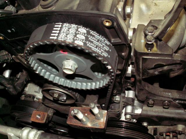

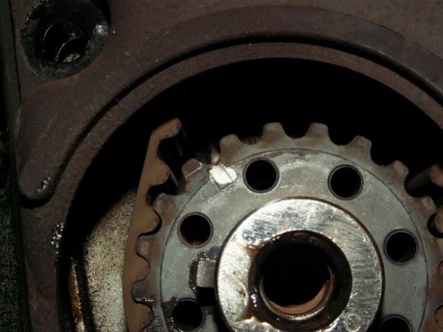

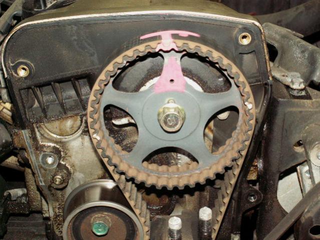

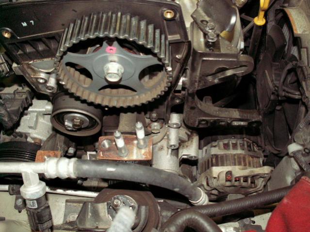

That all depends on how far out of time you actually was..
The timing mark is TDC on the crank (mark on oil pump body and cog),,, mark for cam is a small hole and red line inside on cam cap (the hole is marked with red paint)..
