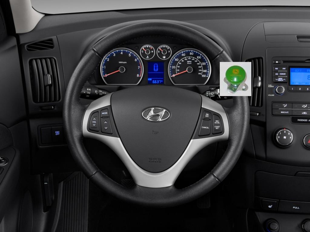

I found a solution. It drives like a Tractor so a John Deere Steering Wheel ****
Attached Thumbnails Alignment check for 2010 Elantra Touring - pulls to the right-2010-hyundai-elantra-touring-4-door-wagon-man-se-steering-wheel_100237820_l.jpg
