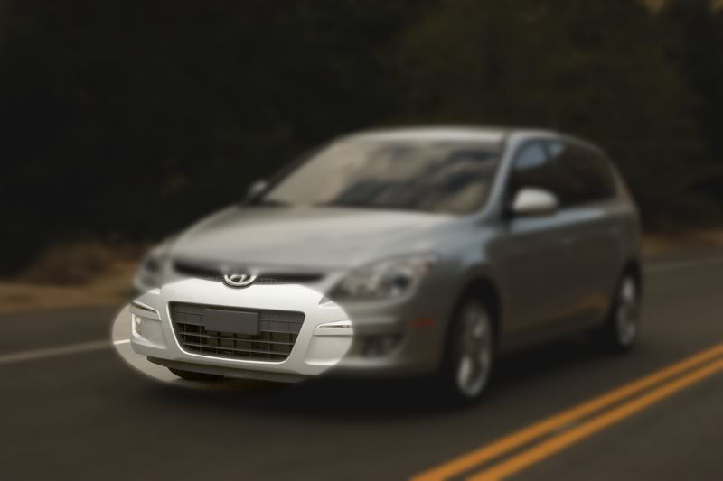

Since I got the attention of those that seem to know what they're talking about, if you folks hadn't yet a chance to read my other question in the other thread about the ET front grill, I'll ask it again here. Is there any way to change the factory plastic grillwork to something more sturdy? I don't care about the looks so much as something that is more robust structurally. The license plate mounts directly onto the flat area of the grillwork, and the entire piece feels rather flimsy at best. Also, how difficult would it be to change the grill work as a DIY project?

You could always try the i30 version because it is slightly different but it might be drilled for European plates, not American plates. Plus, there is no guarantee it's any stronger.
