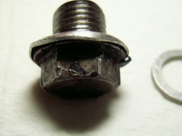

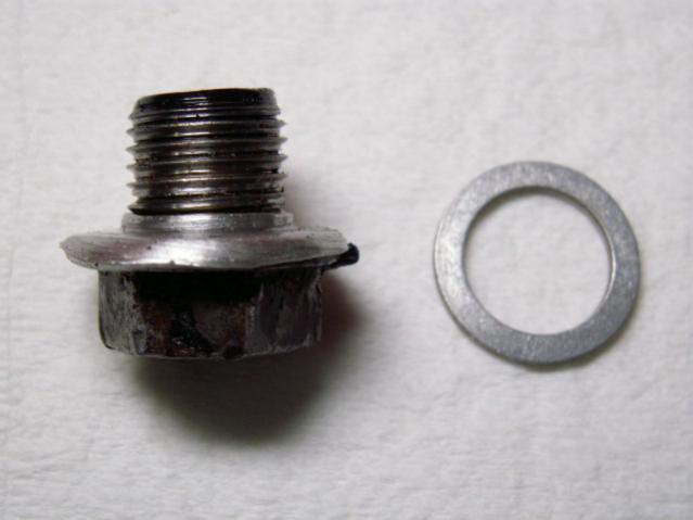

Also of interest, the Hyundai service department almost mandated that I buy their $1 oil plug washer. I think they already have them taped to the top of the box, and to resist buying it, would "upset their streamlined operations." I told her that I have NEVER replaced the washer on my other cars and never lost a drop of oil. When she continued to argue with me, I spent the $1. Now after I removed the plug, the washer would not come off the end of the plug, so I left it on; guess what?.....as with my 1,000 other oil changes on vehicles, the old washer did not leak nor cause galaxies to explode.
These are plain aluminum crush washers, nothing magical about them. Replacing them is a good idea, but you can reuse them once, maybe twice before they get squashed too much. You don't have to buy them from Hyundai. You can buy them from any auto part store in packets for far less. Why the washer is not included with the OEM spin-on filter kits is a mystery. Hyundai does provide the washer in the cartridge filter kits.

I'm sure there were a couple more squeez'enz left on this 1...
You come in with a puked motor and expect warranty, hmmm, $1 coulda saved you a whole lot of grief..
