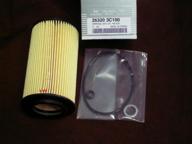

Go to your local Hyundai or Kia shop, and ask for price on a case of the 3C100 oil filter..
Too easy... why fuss with shipping-handling charges, not being home to take delivery, damaged product during shipping, product stolen off porch because fella left it in plain sight, dropped at wrong address across town....
Walk into a Hyundai or Kia dealer parts dept,, buy case of filters, walk out to car and put in trunk, go home... none of the above events happened now... safe and sound same day delivery.
BTW, each 3C100 filter box contains a GENUINE Hyundai/Kia filter element, and a plastic bag with 2 o-ring of proper OD, and a GENUINE Hyundai/Kia drain plug gasket.. no running around looking for parts, they all in the box..
No need to worry about the non-Hyundai o-ring at the cap not sealing the cap to canister... we have people come in with Joes oil change sticker and oil all over top of A/T because JIFFY o-ring is too small OD to seal the canister, so we have oil seeping out under pressure...

Old Nov 1, 2010 | 12:00 PM
Default -3C100 filter kit picture
I have inventory, so I can supply pics...

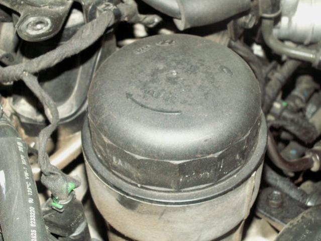

Same engine: 3.3 in a 2007 Sonata. If I want to install JUST the OEM filter cartridge, do I need to drain the oil? My gut says no, because the filter housing appears to be high above the level of oil in the crankcase. Reason I'm asking? I think the last oil change did not use OEM filter and that could be the cause of ticking I hear on cold start up. Got that info from reading through a lot of posts suggesting that not using an OEM filter could be the cause. For the price of a few bucks, I thought I'd try it and see. But, I don't want to do an oil change right now. Thx for any insights you have.

Your gut feeling is correct. Unscrew the cap. When the bottom o-ring seal on the center spindle is pulled loose, the oil trapped in the sump will drain to the crankcase. Wait a few seconds (or minutes) for the residual oil to drain off the filter and spindle, then replace the filter and both o-rings that come with the kit. Screw the filter back on tight and you are good to go. There are torque values published for screwing the cap back on, but I simply screw it on until the plastic lip on the cap comes in contact with the aluminum flange on the sump body. With the large o-ring in place, it can be tough to turn by hand. Go easy with a strap wrench if necessary, but don't over tighten and crack the cap.
I am betting the ticking you hear is the injector tick that is common on this engine. Since the engine use a cartridge filter, there is no other mechanism such a bypass valve, anti-siphon valve or head plate on or in the filter to restrict flow. The oil flow issues are related to the canister type filters used on other engine designs.

Old Nov 27, 2010 | 12:29 PM
Unscrew cap, lift slowly incase canister full of oil, swap filter... change the large o-ring... a lot of them non-Hyundai rings or used ring are too small diameter to seal to the canister real well..
Here is aftermarket ring -- it leaked all over.. not warranty :
Here is OE ring from -3C100 kit, notice the height above the surface, it will compress into the canister and seal good...
Attached Thumbnails 2007 Santa Fe 3.3 V6 Oil & Filter Change - Tools and Parts suggestions-pict0409.jpg   2007 Santa Fe 3.3 V6 Oil & Filter Change - Tools and Parts suggestions-pict0578.jpg   2007 Santa Fe 3.3 V6 Oil & Filter Change - Tools and Parts suggestions-pict0581.jpg
