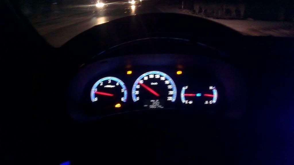

I am using a Santa fe 2009, diesel. Last month, there was 3 indicators light on.
I took my car to Huyndai Services Care but they'd just clear errors then it was off.
Two days later, the 3 indicators light turn on again, I don't know what happen.
Anyone get troubles like me? What should I do? What could I repair/fix or replace items for turn it off and work correctly?

Looking at the owners manual it appears the lights are:
Upper Left = ESC OFF
Upper Right = ABS
Lower Left = Downhill assist
If those are correct I'm going to guess that the problem is the brake light switch on the brake pedal. Let me ask you this, does the cruise control work? If not, it probably is the brake light switch. Many hyundai's have this problem and it's actually a recall. The cruise control, downhill assist, ABS and ESC all use information from the brake light switch to know if you are on the brake or not. If the switch is malfunctioning then all those system will not function and light those lights.

Another possibility is a wheel speed sensor problem. Santa Fe's has an issue with the tone ring rusting and cracking also causing this problem. So also get the wheel speed sensors themselves checked.
