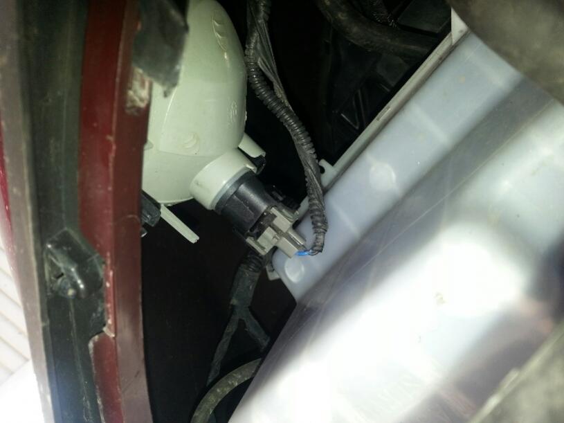

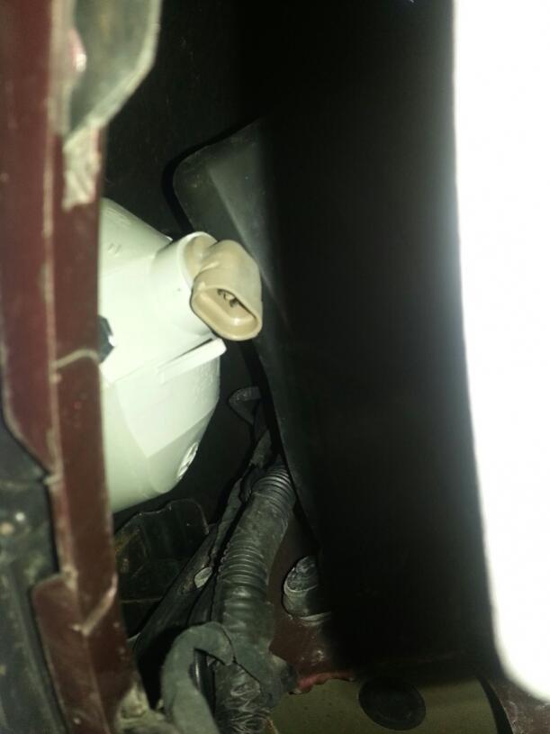

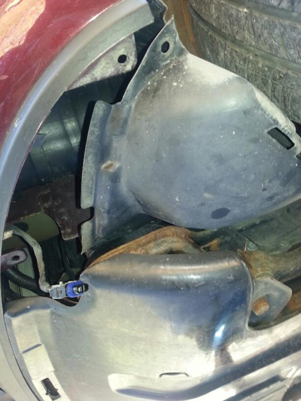

See photos for access and the completed install of the passenger side which has the tightest access to get the bulb into. Two corner plastic clips to pull down the assembly. That's it and I used a short bungee cord to hold the end away so I could see inside better.
