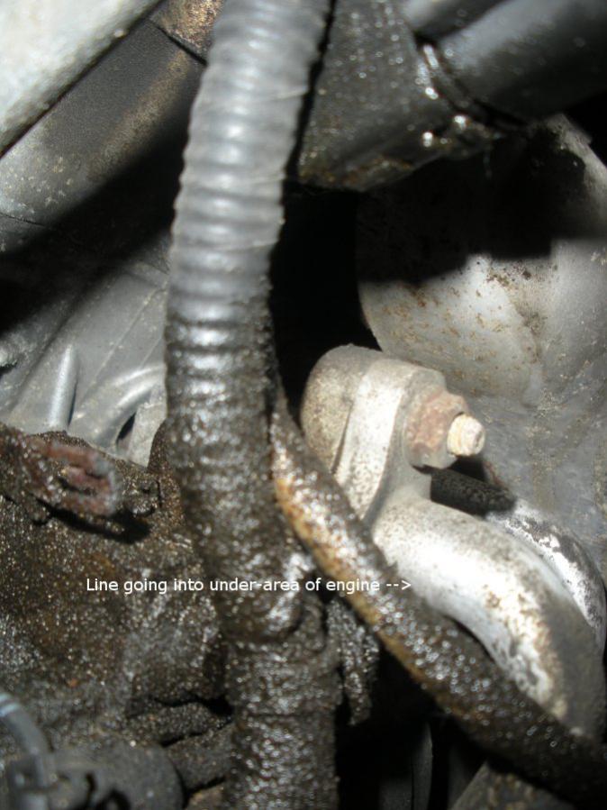

Thanks for your response. I'm not sure how important this is, but the lines for the AC run from the back-left side near the dashboard up to the front-left by the front-left headlight and then down and to the right to the underside of the engine.
I took a picture of where the lines hook into the area by the dashboard, the area where the missing part is from a different angle (from near the front-left wheel) and got a picture of the lines where the attach on the underside of the engine.

Old Jul 25, 2010 | 05:33 PM
At a minimum, I can see the condenser and receiver/drier is missing..
I cannot see if the triple switch wire is present, you'll need to buy the triple switch too, as it not come with drier.
In the pic you have marked left front down in the corner,,, that is actually the right front (passenger side).... left front is the driver side..

Yeah, you'll need to triple switch as well as the condenser / drier.
