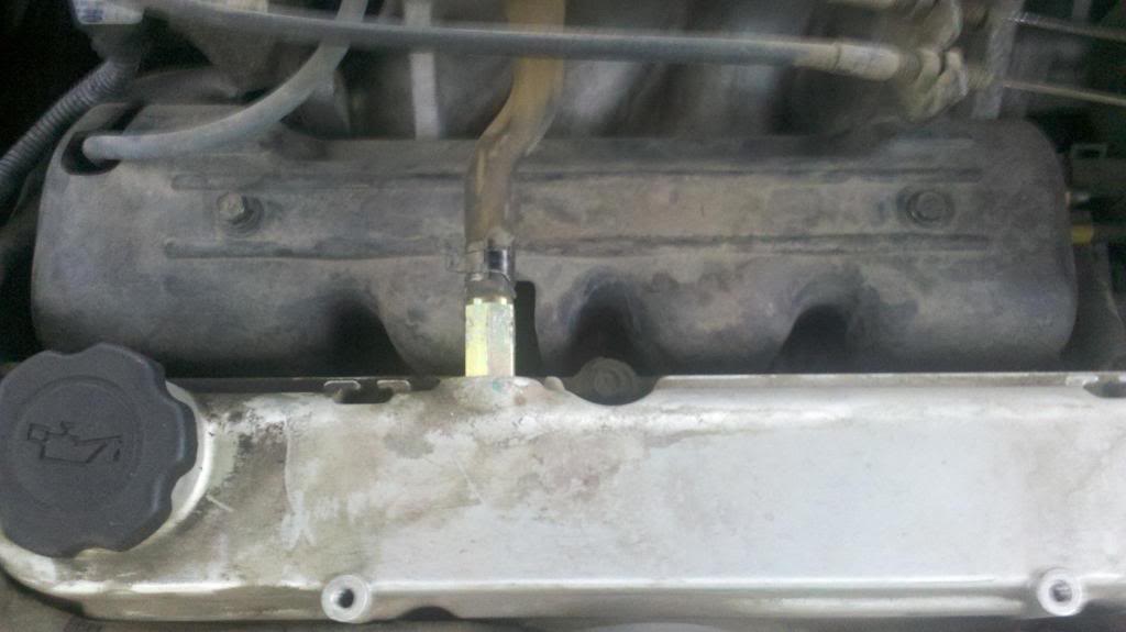

Not too familiar with the engine, not familiar at all. So where do I find the spark plugs? Here's a couple pics of where I 'think' they are.
I pulled the boot off and there is a long plastic looking thing, is there a plug down there? This one is located on top of the block
http://i627.photobucket.com/albums/t...00-4495117.jpg
This second pic is behind the block, with a plastic-ish cover which i'm not quite sure how to remove but looks like there's a plug wire going into it.
Attachment 1783

Well, go buy some real HYUNDAI wires, and the ends wont pull off like your inexpensive discount parts store wire did..
Wire end likely burnt through, or plugs need to be changed.
Install NGK Platinum ONLY, buy real Hyundai / Kia wire set, and look very carefully at the coil' bodies for large white/grey spot.

What is the writing on the wire ? Those in your pics look grew with black boots...
Does that black long plastic thing in the first pic come out or what?
That black thing in the hole is the rest of the wire end that is broken off the wire you is holding... in 7+yr of Hyundai, I have never seen a factory Hyundai wire break like that, it is always aftermarket wires that do that.
Not sure how they work on this car
Same as any other ignition system, coil on top of plug, and wire runs from ignition source to spark plug.. The 2.4 is a waste spark system, coil on 2 and 4, wire on 1 and 3..
Don't bother removing the black plastic cover, nothing under there you need mess with.

So it's just the two wires/plugs under the big cover then? How do I get the long plastic thing out of where the boot was pulled off of?
sbr711 Dec 4, 2010 08:49 AM
Reach down inside and pull it (wire end remnants) out, then use spark plug socket and remove the spark plug
