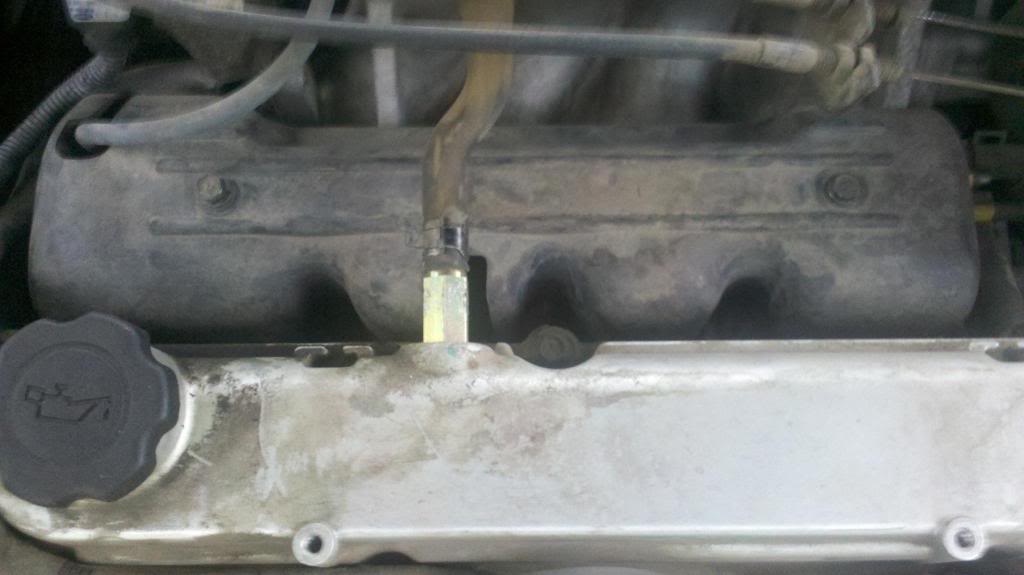

Not too familiar with the engine, not familiar at all. So where do I find the spark plugs? Here's a couple pics of where I 'think' they are.
I pulled the boot off and there is a long plastic looking thing, is there a plug down there? This one is located on top of the block
This second pic is behind the block, with a plastic-ish cover which i'm not quite sure how to remove but looks like there's a plug wire going into it.

Does that black long plastic thing in the first pic come out or what? Not sure how they work on this car
That black thing in the hole is the rest of the wire end that is broken off the wire you is holding... in 7+yr of Hyundai, I have never seen a factory Hyundai wire break like that, it is always aftermarket wires that do that.

Same as any other ignition system, coil on top of plug, and wire runs from ignition source to spark plug.. The 2.4 is a waste spark system, coil on 2 and 4, wire on 1 and 3..

Don't bother removing the black plastic cover, nothing under there you need mess with.
Reach down inside and pull it (wire end remnants) out, then use spark plug socket and remove the spark plug
