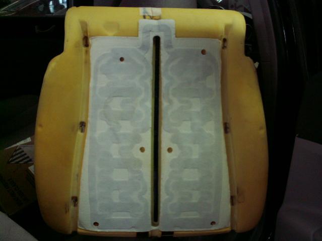

Here's your $1400 seat bottom --
Have to post pics later, left the camera card at work again....
Old Apr 22, 2011 | 06:20 PM
Default Almost left card at work again, I got here now--
New in bag seat cushion for passenger seat-
Underside, just the white module on that piece of foam with fabric cover on other side -
Top side where you sit,, minus the covering to make it pretty -
Seat frame for cushion to sit on, wiring at bottom of seat -
Attached Thumbnails 2006 Sonata drivers airbag light stays on-pict0622.jpg   2006 Sonata drivers airbag light stays on-pict0624.jpg   2006 Sonata drivers airbag light stays on-pict0625.jpg   2006 Sonata drivers airbag light stays on-pict0629.jpg
