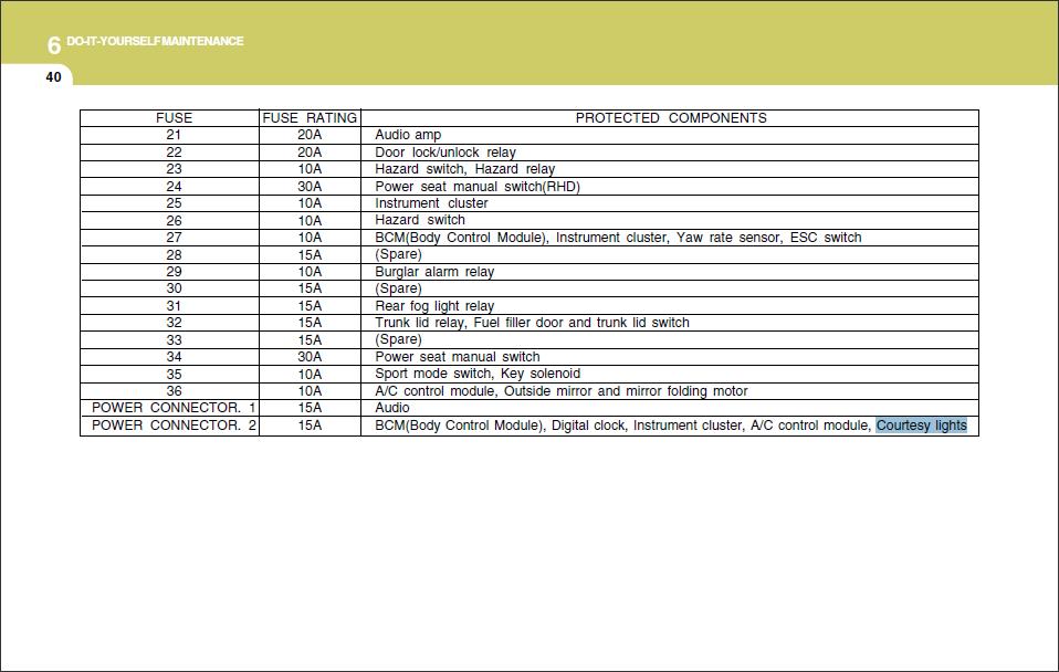

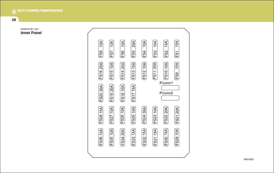

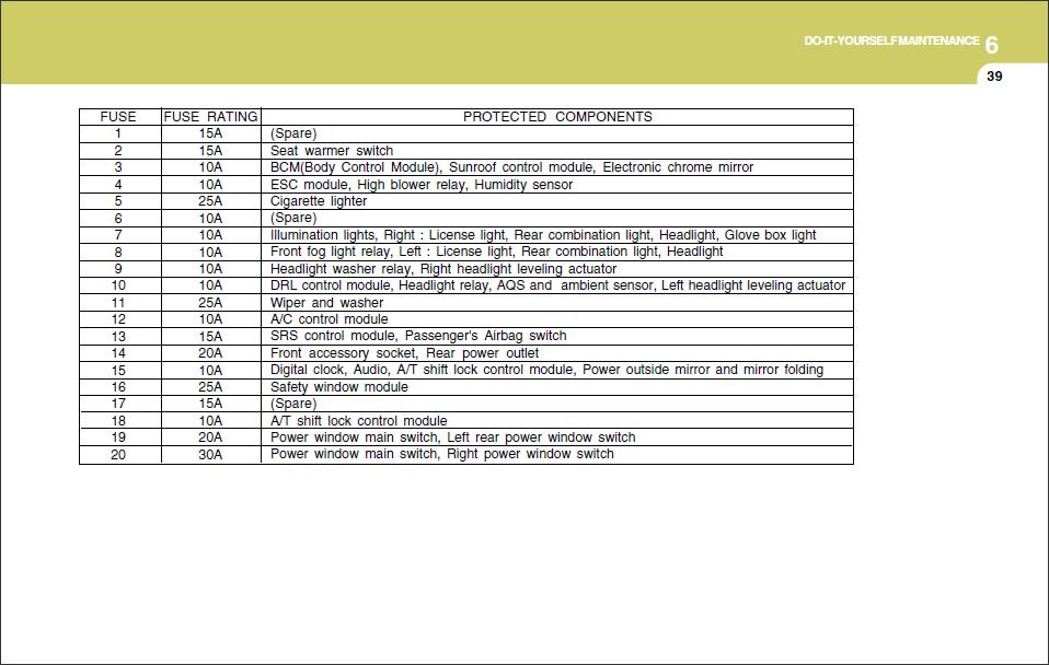

Did you check the owners manual? Specifically pages 6-38 thru 6-40:
Attached Thumbnails 2007 Hyundai Sonata Inside Lighting-2007-sonata-6-38.jpg   2007 Hyundai Sonata Inside Lighting-2007-sonata-6-40.jpg   2007 Hyundai Sonata Inside Lighting-2007-sonata-6-39.jpg

Yes and there is nothing specific that says interior lights or dome or anything close to it.
