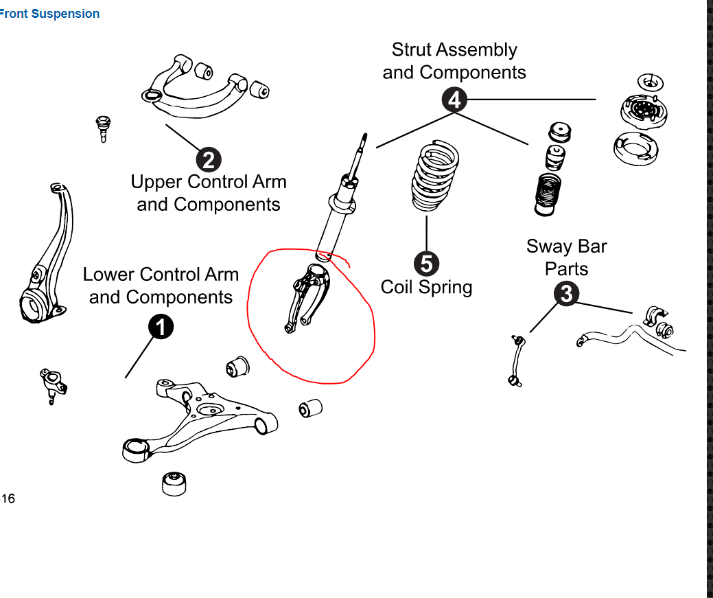

I am preparing to replace driver's side lower suspension arm due to a squeaking strut fork bushing and I will be replacing the front disc brake pads as they are beginning to squeak when stopping from low speeds.
I have a 2010 Hyundai Sonata GLS I bought used in January 2016. It has about 179K miles on it but it appears to be mainly highway miles; car is in remarkably good condition.
I was looking for information about replacing the lower shock fork bushing in the control arm and that is how I found the forum. I haven't been able to find a source for the bushing so I just bought the complete control arm from MOOG for $117.

Lower control arm is the same as lower suspension arm or front suspension lower arm. The strut as Hyundai calls it attaches to the lower control arm just to the inside of the lower ball joint. The attachment is through a 2-prong fork with the drive shaft going through the fork to the front hub. The fork straddles the lower suspension arm and is mounted with a bolt through a steel and rubber bushing. THe 2010 Hyundai Sonata GLS does not have the traditional McPherson strut, but an upper and lower control arm joined by a steering knuckle. The hub bearing & hub are attached to the steering knuckle (not spindle). Spindles are used on the front of Rear Wheel Drive (RWD) cars with individual inner and outer tapered roller bearings running between the whell hub and the spindle. The bearing assembly is held on by a washer and nut on the outer end of the spindle, then covered by a domed dust cap.
I was looking for this particular bushing as I have seen exploded drawings of the front suspension parts and an individual bushing is shown for this location on the lower control arm.
I ended up purchasing the entire new lower control arm for $117 from MOOG. It seems easy enough to take off and replace with new parts. Also purchased a new lower ball joint so I don't have to screw around with getting the old one off.
