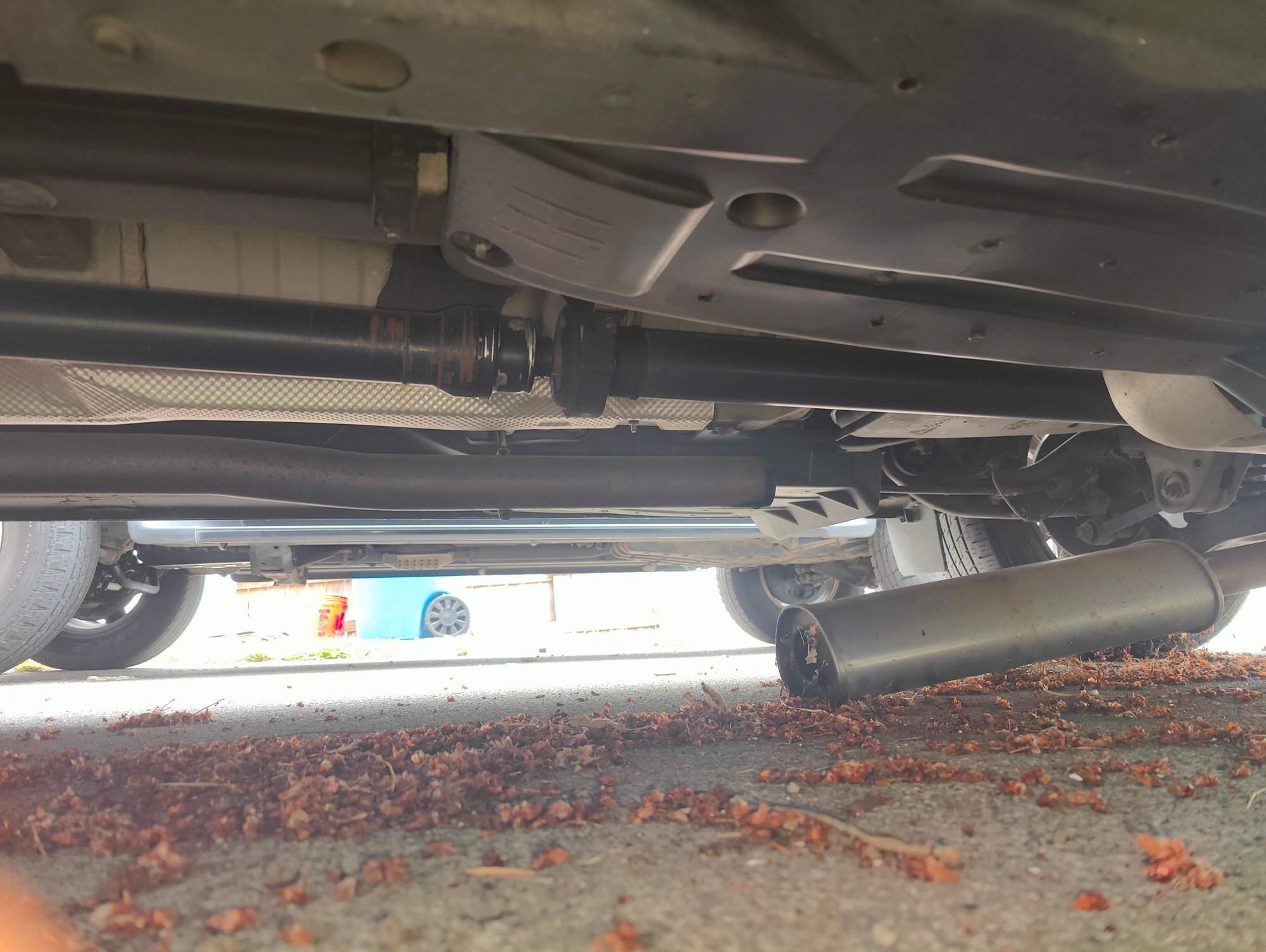

I have a 2014 Hyundai Tucson GLS AWD. My girlfriend called me and said she heard weird noises from underneath the car. So this is what I have:
What the heck do I do? Can I order a coupler from Amazon? And if so, wouldn't it be difficult because of where the "break" happened? I mean, it does straight into the muffer right?
Thanks in advance for any help and please excuse my lack of correct terminology. I've had this Hyundai since 2014 Brand New and its served me well, I wanna get her back on the road.

The only correction for this is to replace the entire exhaust system from the converter back . Not a difficult job, but without the right tools can be !
Has to be very loud without the muffler doing its job.
Choice of buying parts and installing them or have a shop do it.
