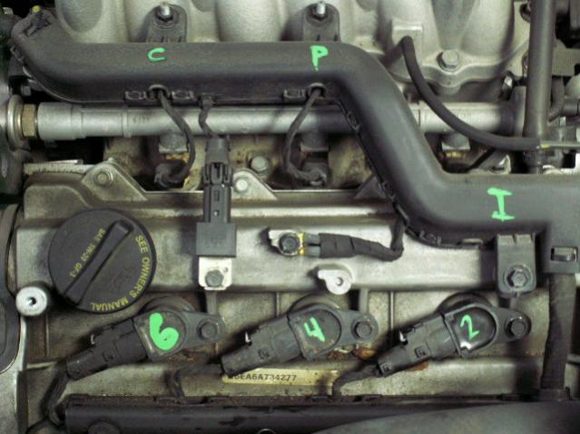

Before you drop coin on the coil,,, take 1 of the coils from the exposed bank and put it in #1.. mark the #1 coil and install it to one of the exposed holes at front.. drive it, and see if the misfire follows to the hole where the coil now resides..
This is common way to test,, example seen in pic.. came in with 0306 --
Left the injector in #6 (too time consuming to swap)..
Moved to coil to #2
Moved the plug to #4
Test drive --> MIL --> P-0302 ---> coil fault
BTW -- Warranty paid my diag time, and I documented it with this pic and GDS prints attached to repair order.
