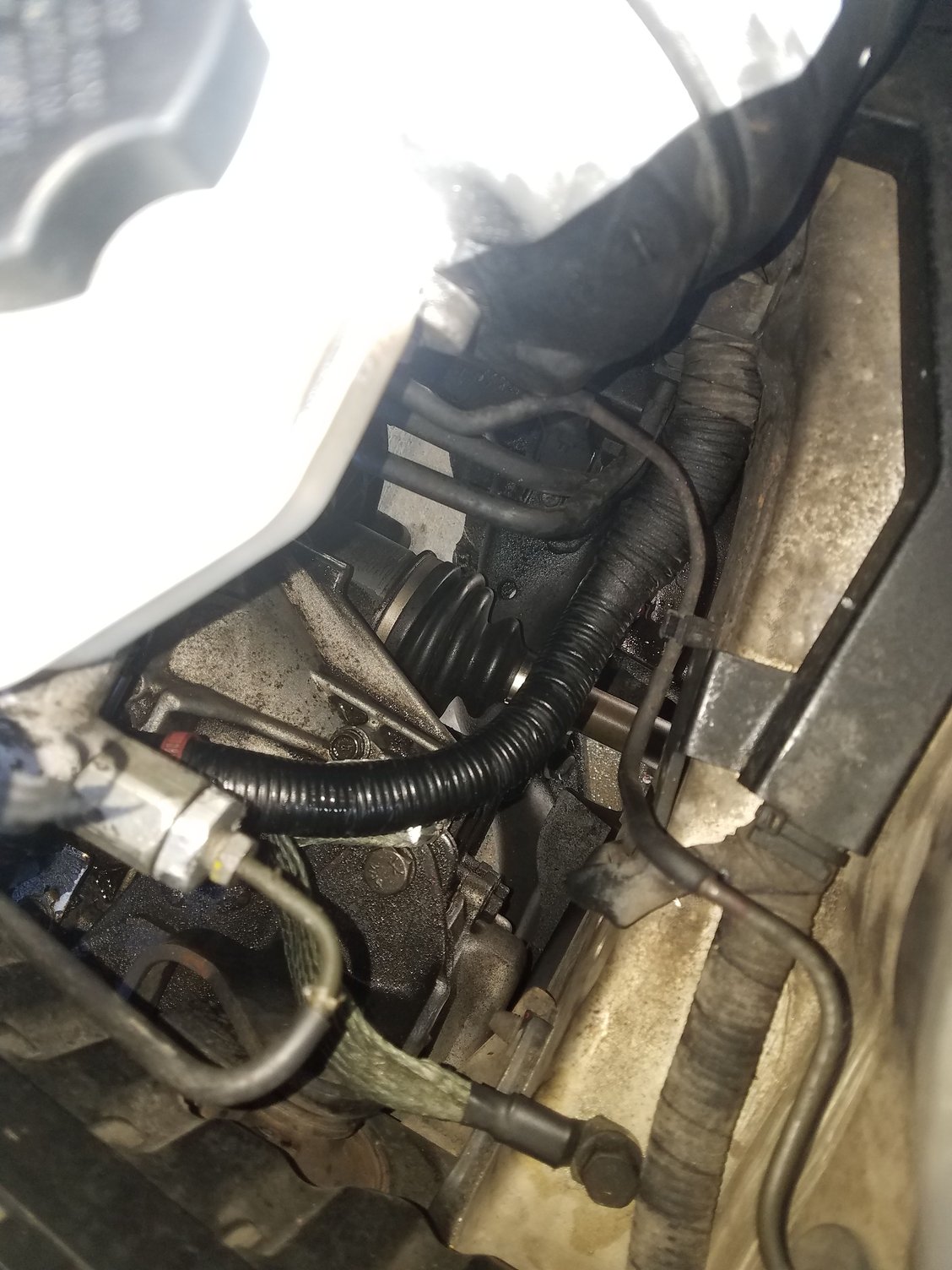

Thank you for your response, and I apologize for the short description. Well, I just bought a 2005 Hyundai Elantra gt off someone last week but I notice that under the master cylinder there was leaking going all the way down to the tire's arm. After inspecting everything there, I use a paper towel to tap on the valves(I think those are the proportioning valves) and I notice that fluid was coming out of both of them from the o-rings. I attached some pictures so you guys can see what I'm talking about.

Javier, that makes me think that someone either had replaced the master cylinder or tried bleeding the master cylinder and messed up the O-rings and possibly the sealing surfaces as well. The hex on the left connector seems rounded. Beginners tend to use too much force.
Before spending money I would take this apart and inspect the O-rings and the seal surfaces and the threads. Also look for damage on the flange of the line. If you are not familiar with this kind of work I suggest you look at some You-tubes on changing the master cylinder or give it to a professional. After all, brakes are kind of important.

Hey allegretto I did what you told me, and you just saved me a bunch of money. I really appreciate your help! The O-rings were messed up. After I replaced them, the leaking stop right away. Thanks again my friend.
