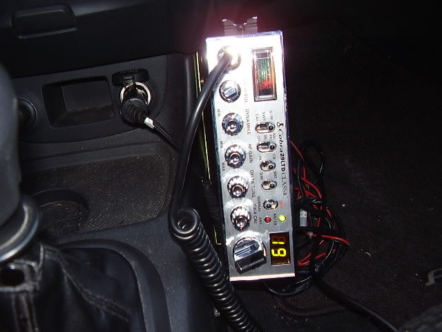

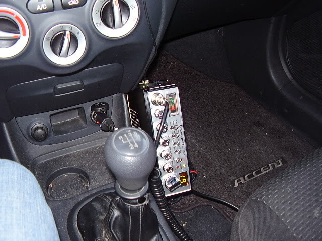

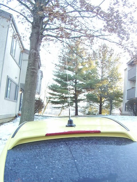

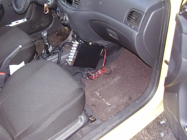

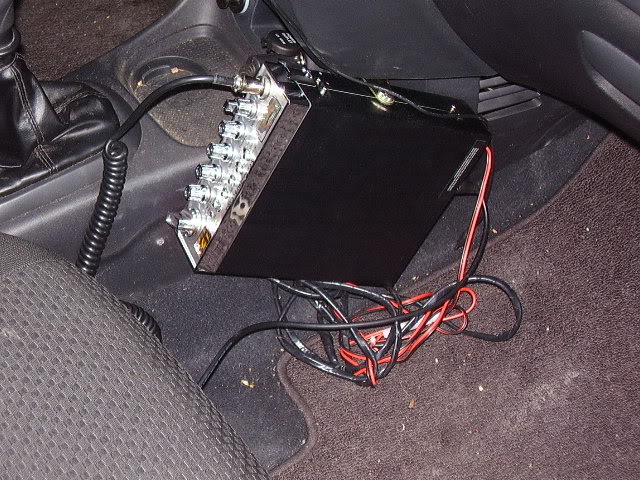

I havent been on in a while. Figured I would post up my recent install.
I just finished installing my Cobra 29LTD Classic w/ Wilson Little Wil antenna.
Works great in here. Only complaint is ignition noise. I need to install a noise surpressor.

I still need to tuck the coax cable under panels and hard wire the power. I am waiting on another pigtail to come in before I do that cause I want to keep the cig lighter adaptor for my 18 wheeler when I do runs to Indy.
