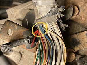

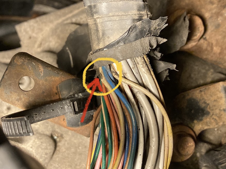

Old Jul 7, 2022 | 08:11 PM
  #13
Whiteg77's Avatar
Joined: Jun 2022
Thumbs up Problem solved
Found the wire causing the problem. Pic attached for the next guy.
Old Jul 8, 2022 | 04:25 AM
  #14
s-petersen's Avatar
Joined: Jun 2020
Posts: 134
From: Goshen, NY.
Pesky bugger!
Old Oct 27, 2023 | 01:31 PM
  #15
Shokotti's Avatar
Joined: Oct 2023
Exclamation
Originally Posted by Whiteg77
hi - I’m having the same problem on my 2013. A slight tug on that bundle of wires blows the fuse. Do you know which wire was the culprit or maybe any tips to offer? Thanks.
Thanks from Ukraine for the tip, I had the same problem, and the second "SENSOR" fuse blew too. I Found two frayed wires in this place!
