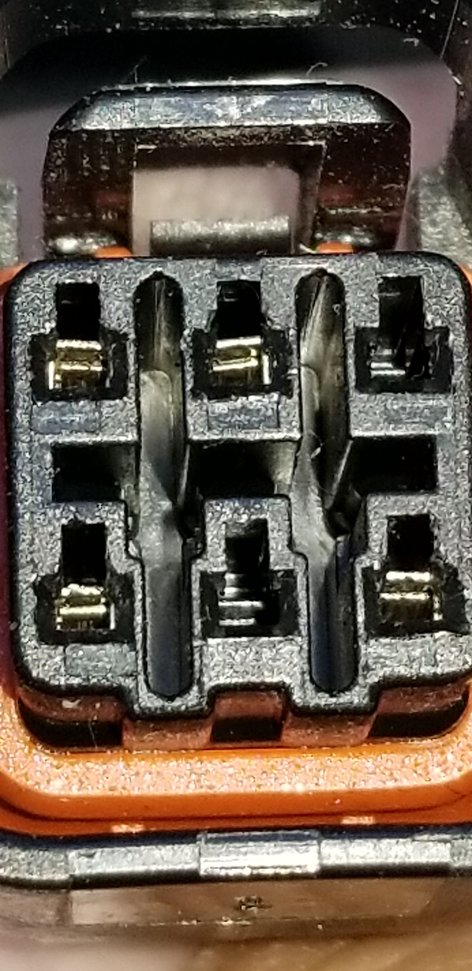

The service manual says I should have continuity between terminals 1 and 3 I don't have a terminal on number 3.(if the service manual referring to the plug on the harness)
And I do not have a path to ground on the red wire. The gray wire does have a path to ground. And no continuity between the red and the gray wire.
I used a test light for the next steps
Gray to ground test light comes on when I press the lock button
Red to ground light comes on when I press the unlock button
Only have power between the red and the gray wire when I press the unlock button
And nothing when I press the lock button
is it possible that I have a problem inside the fuse box itself since I've got power on the red wire but no ground?

When not using switch, the red and grey wires are at ground
When the switch is used, either one of the red or grey wire goes to power .. the actuator depending upon lock or unlock is chosen
You tested and there is no ground on the red wire.
Now it is a matter of finding the reason why. Trace red wires to those relays
Look into fuse box. You are so close to finding the problem.

When not using the switch I do not have ground on the red wire, but I do have power on the red wire when I use the switch.
so I'm thinking the wire should be good from the actuator to the fuse box.
I'll have to take a look at the wiring diagram and see if I can find where the wire goes on the fuse box.
