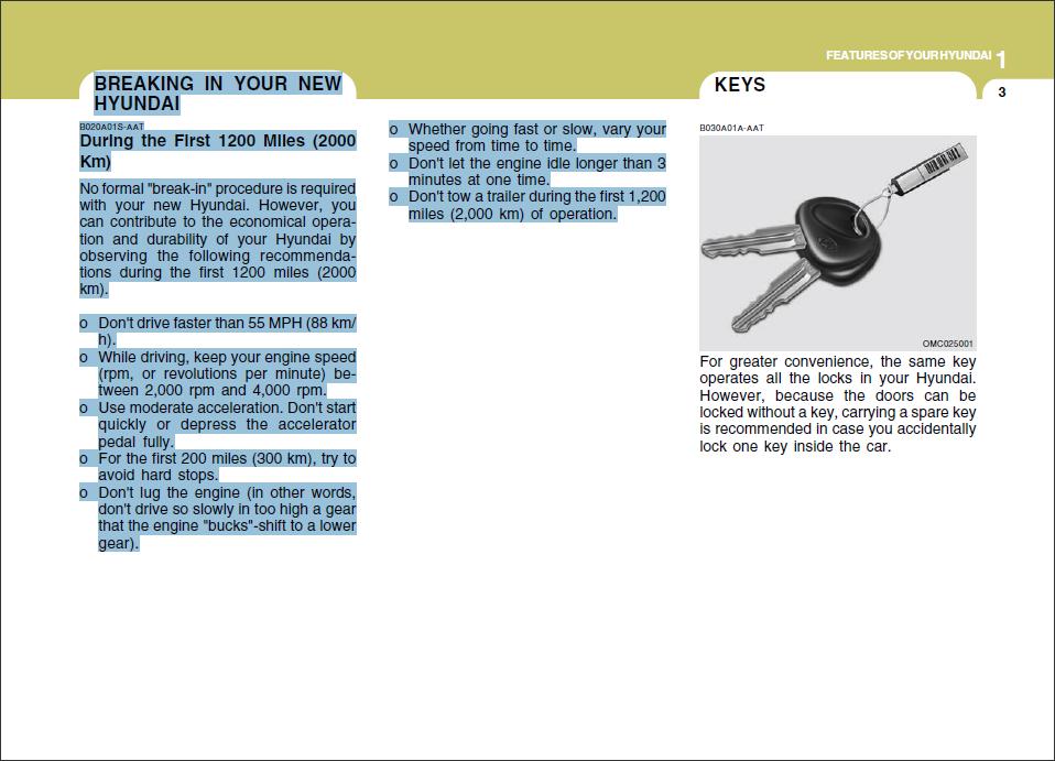

An update after 6 month driving this accent 2010. The gas mileage haven't change a bit, still sucks! Right now is about 8000 miles. Nothing has change, still 24mpg with AC on. 27mpg without AC. There are no such a thing called "Break-in" period, according to a car expert, every engine has tested and run in the factory over 5000 miles before coming out to the sales lot. Break-in is a lie from the salesman.

FYI, 27-mpg is exactly what the Accent hatchback with an automatic is rated for city driving. (SOURCE) So the mileage doesn't suck, it's NORMAL. If you wanted a car with better economy, you should have done better research.
Yes there is. While it's nothing overly elaborate, there is a break-in procedure that is explained in the owners manual (have you read yours?). See page 1-3:
100% BS
There is no way Hyundai (or any other car company) runs every single engine over 5,000 miles before you buy it. Just not true. They take a few cars off the line to test them and do quality control on but those are not sold to the public.
Why would anyone buy a new car that has an engine with 5,000 miles on it? Not true. The engines are assembled and installed without being run. They are then started for the first time and driven less than 2 miles between the assembly plant and any transportation to get them to the dealer.

I am one of those people who reads the book front to back, and I am DEFINITELY adhering to the break-in ritual. As a result I am getting 33-34 mpg in Alabama hot weather, and look forward to it getting better once the pistons seal and the engine settles. As an A&P mechanic who works on new and used aircraft engines, I can promise that engine break-in is very much a fact.
